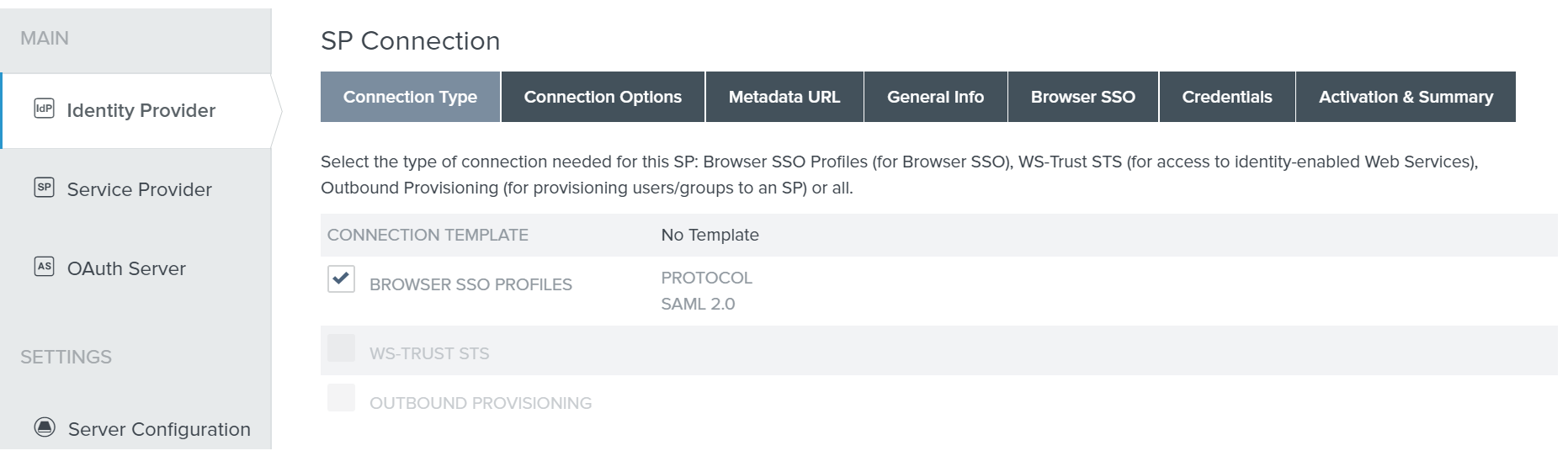

3. In the tab, select .

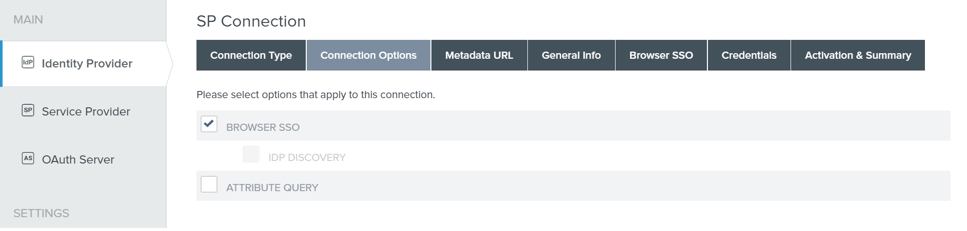

4. Click the tab.

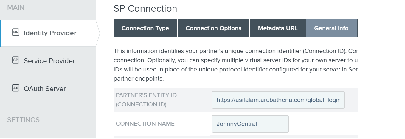

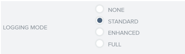

5. Verify the Entity ID and select the logging mode.

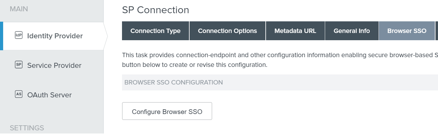

6. Click . Configure the Browser SSOSingle Sign-On. SSO is an access-control property that allows the users to log in once to access multiple related, but independent applications or systems to which they have privileges. The process authenticates the user across all allowed resources during their session, eliminating additional login prompts. Settings.
1. On the page in PingFederate administrative console, click .
2. Click .

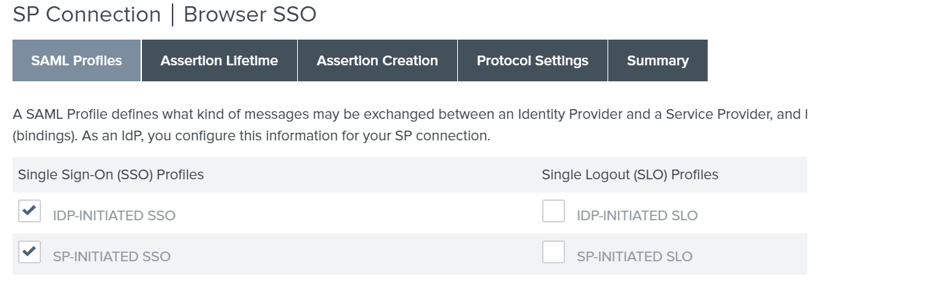

3. Select the following SAML profiles:
Select IDP-INITITATED SSO
Select SP-INITITATED SSO

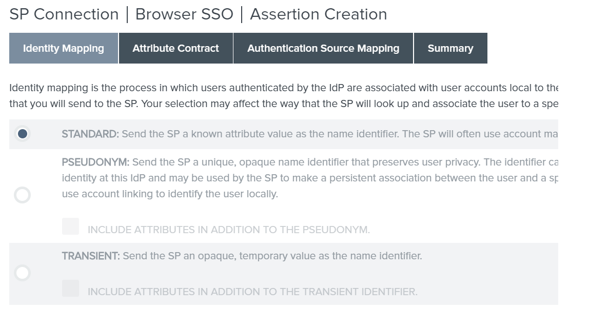

4. Click . The tab opens.

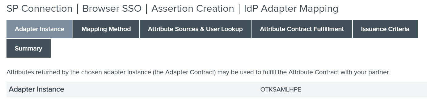

5. Click . The page opens.
a. Click . The wizard opens.
b. Click . The page opens.

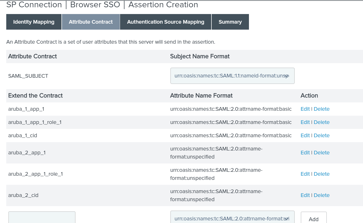

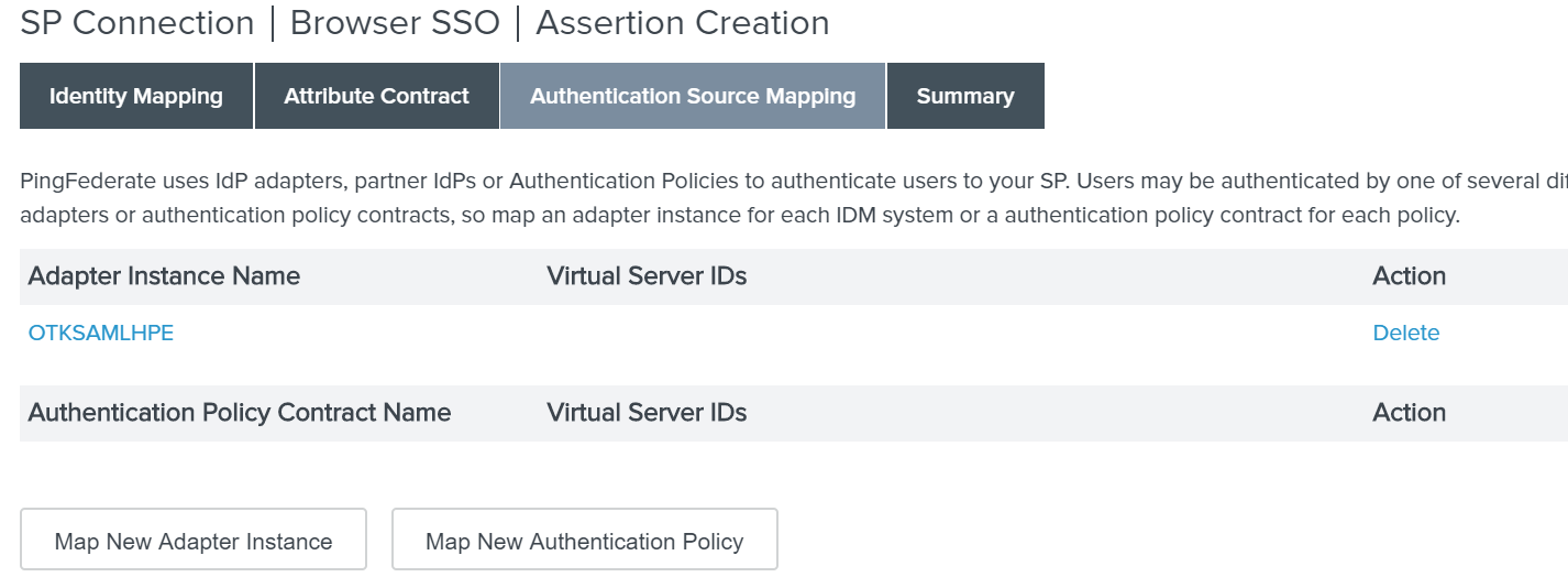

c. Add the SAML attributes in the SAML assertion. The IdP will send these attributes in the SAML Assertion.
d. Click . The tab opens.
e. Click . The adapter configuration screen opens.
f. Complete the following configuration steps:

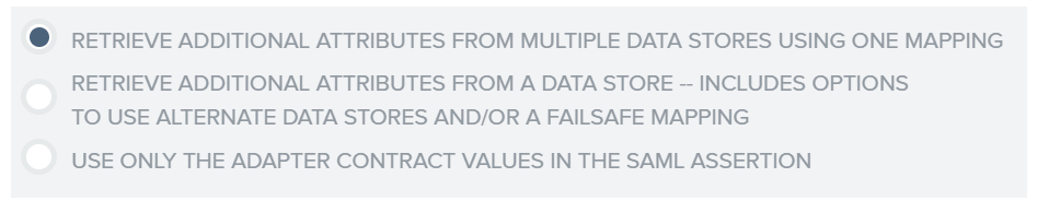

g. Click and select a mapping option.
h. Click

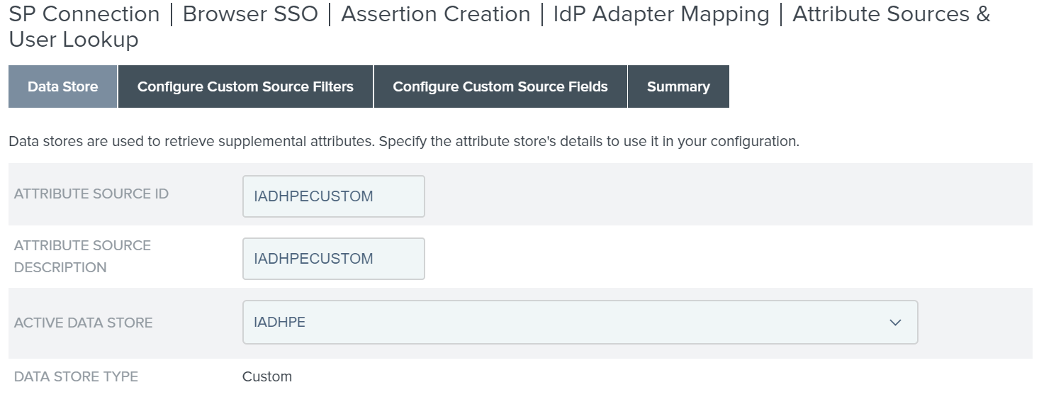

i. To add a data source, click and add the data store ID as shown in the following figure:
j. Click .

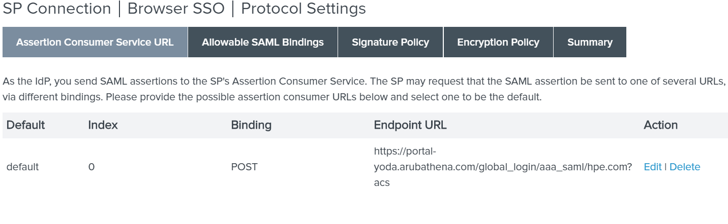

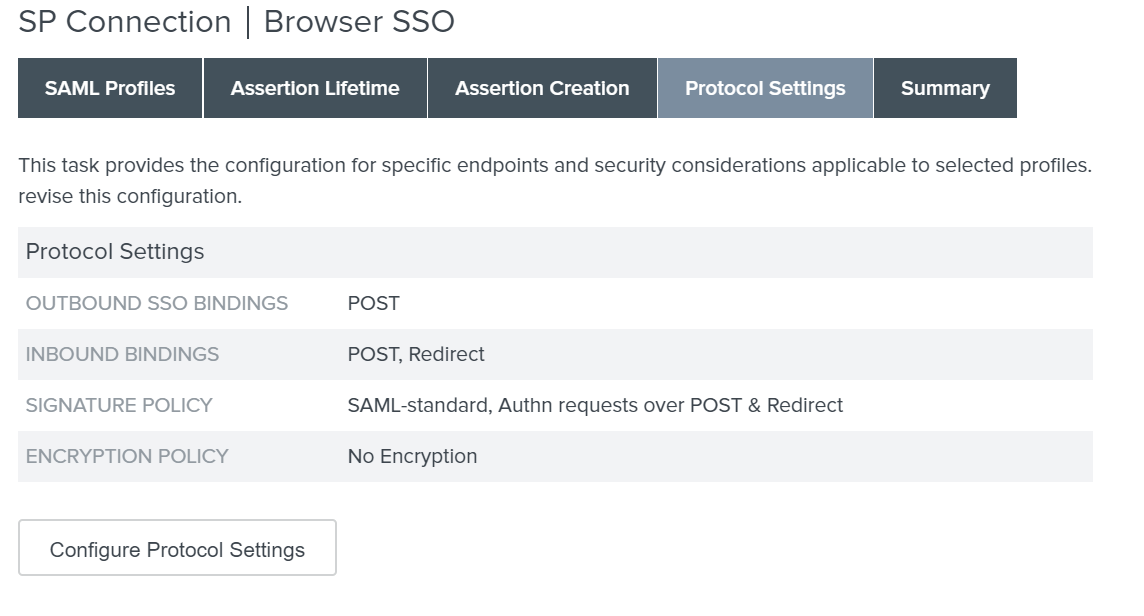

6. On the > page, click to configure the Browser SSO Protocol Settings, SSO service URLsUniform Resource Locator. URL is a global address used for locating web resources on the Internet., and SAML bindings.
7. Click and complete the following steps:

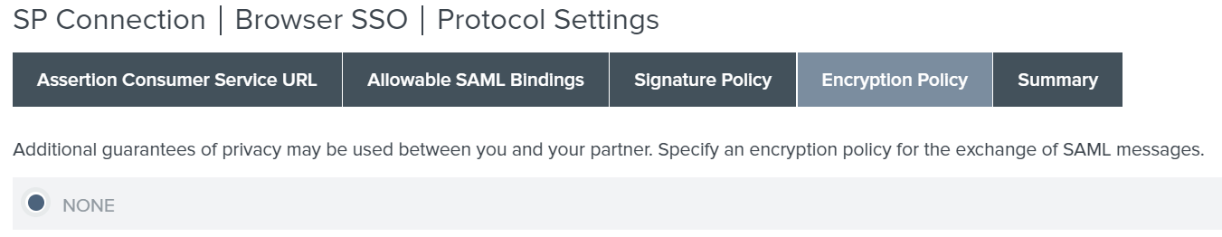

a. Verify the . The endpoint URLs for Redirect and Post bindings are both automatically populated from the metadata. If not, enter the URL manually. The URL will be the same for both bindings.

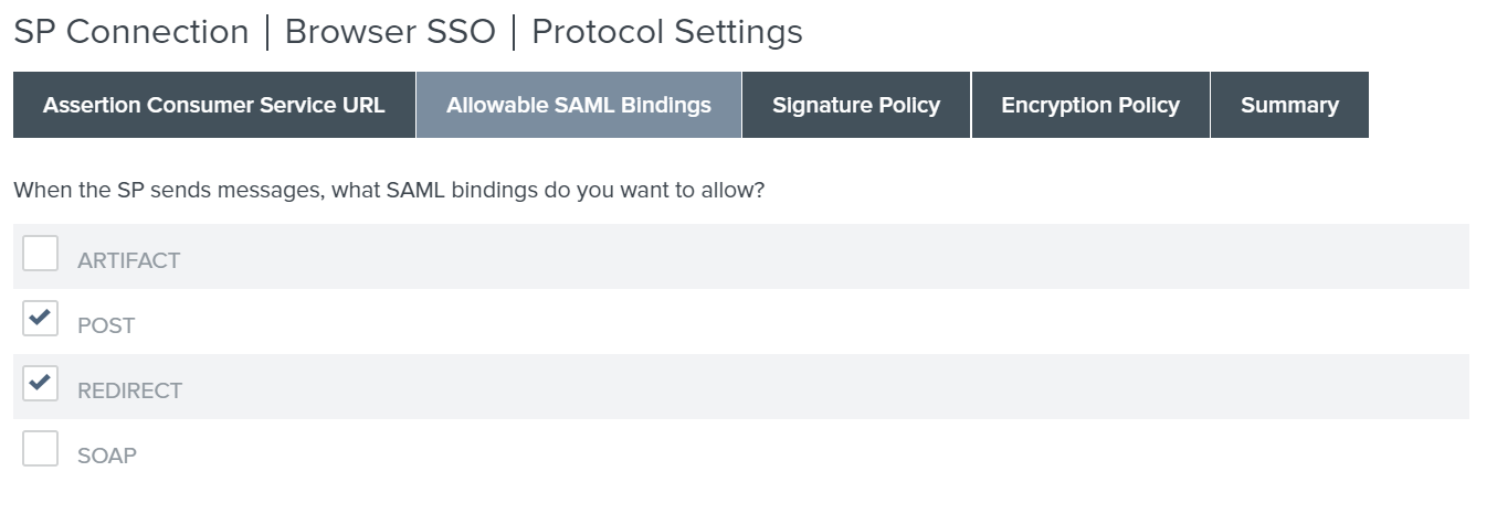

b. Click . The tab opens.
c. Select and .
e. Select .
f. Click . Review the protocol setting.
g. Click .

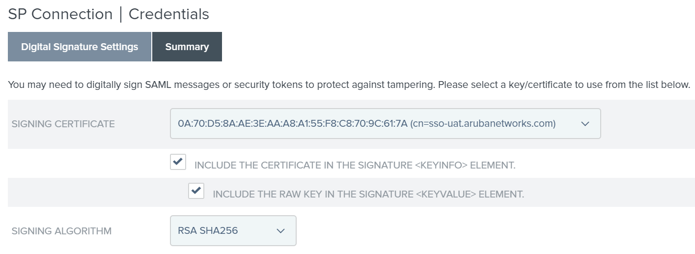

1. On the SP Connections page in the PingFederate administrative console, click
2. Click .
3. Click .
4. Select the certificate to use for digital signature in SAML messages.
To review the configuration, click the
tab.
