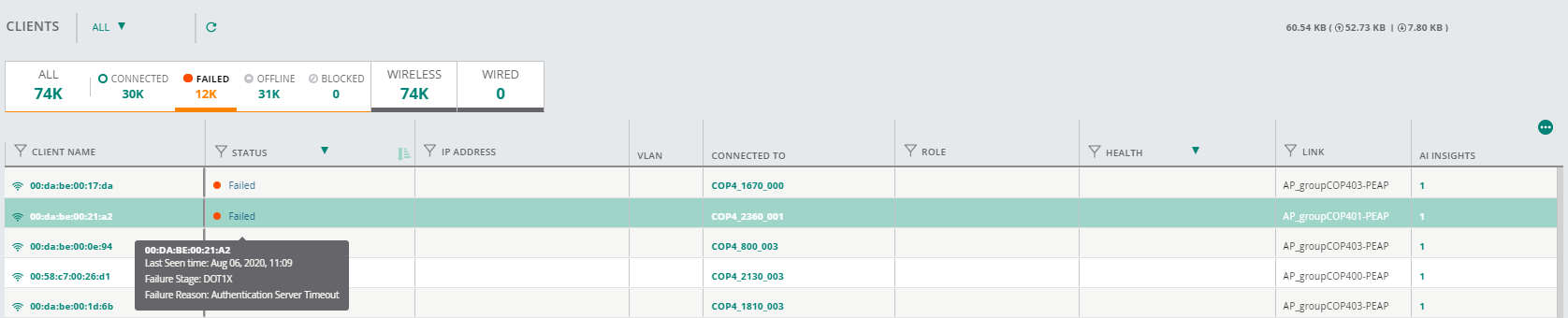

To view failed clients and the reason for their faulure, complete the following steps:
1. In the app, use the filter bar to select a group, label, site, or a device.
2. Under , click . The All Clients overview page is displayed.
3. Click from the clients summary bar to view a list of all the failed clients.
4. Hover over the status of a particular client to view the following information. This information is provided by the AI Insights feature based on algorithms and smart analytics:
- Date and time at which the client was last seen
- Failure status of the client that failed to connect. The failure reasons could be:
Association error
MACMedia Access Control. A MAC address is a unique identifier assigned to network interfaces for communications on a network. authentication error
Key exchange error
- Based on the failure stage, failure reason is populated. For example, if it is a 802.1X authentication error, the reason for the failure could be .
5. You can also view if any AI Insight is associated with the failed client by clicking on the number under the AI Insights column. This will lead to Insights page.
