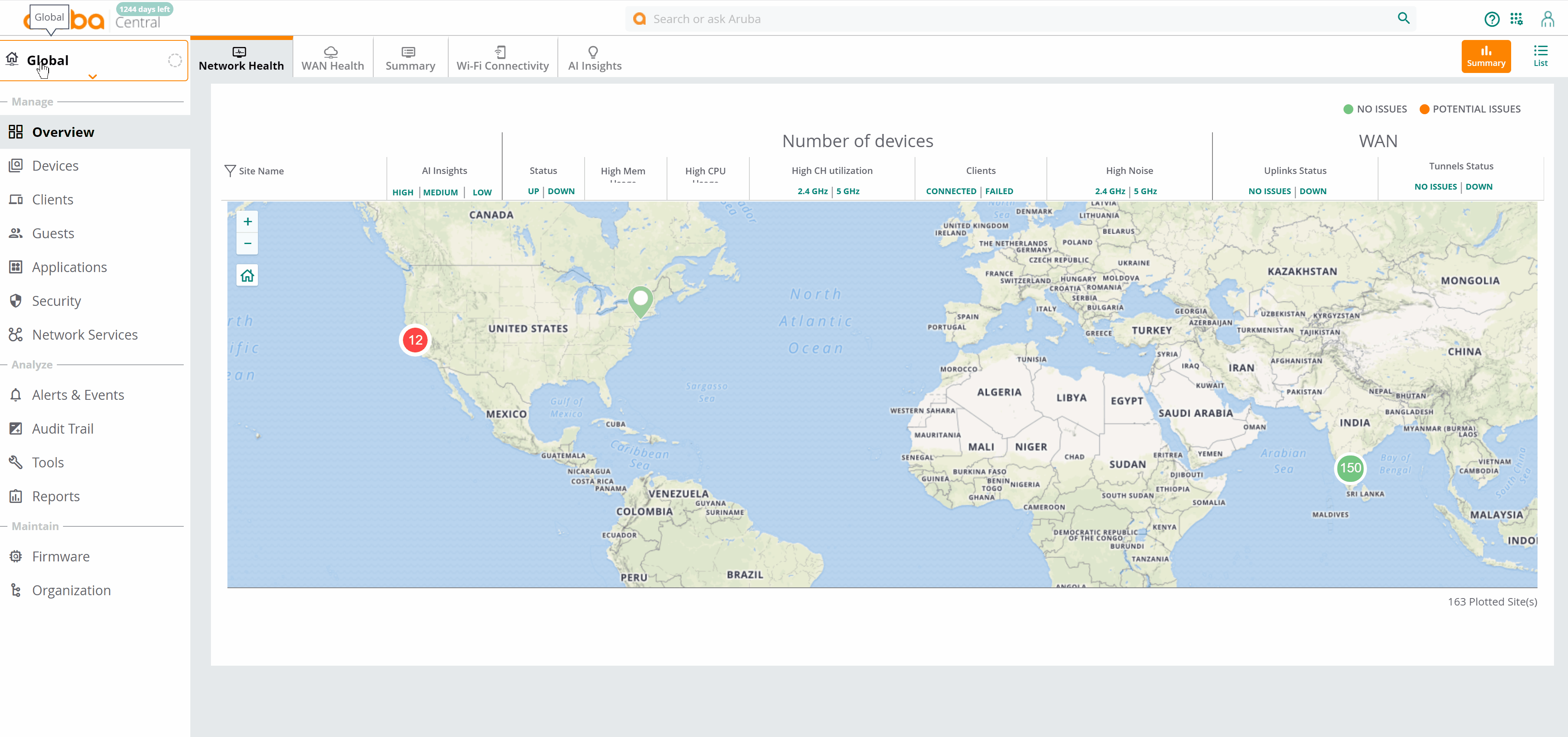

To delete an offline switch:
- In the app, set the filter to one of the options under , , or . For all devices, set the filter to .
Ensure that the filter selection contains at least one switch.
- Under , click .
A list of switches is displayed in the view.
- Click to display a table with the list of offline switches.
- In the table, hover over the offline switch that you want to delete.
- Click the
delete icon.
To delete multiple offline switches, select the offline switches that you want to delete, and click the
delete icon at the bottom of the page.
- Click in the dialog box.
The following animation shows you how to delete an offline switch:
