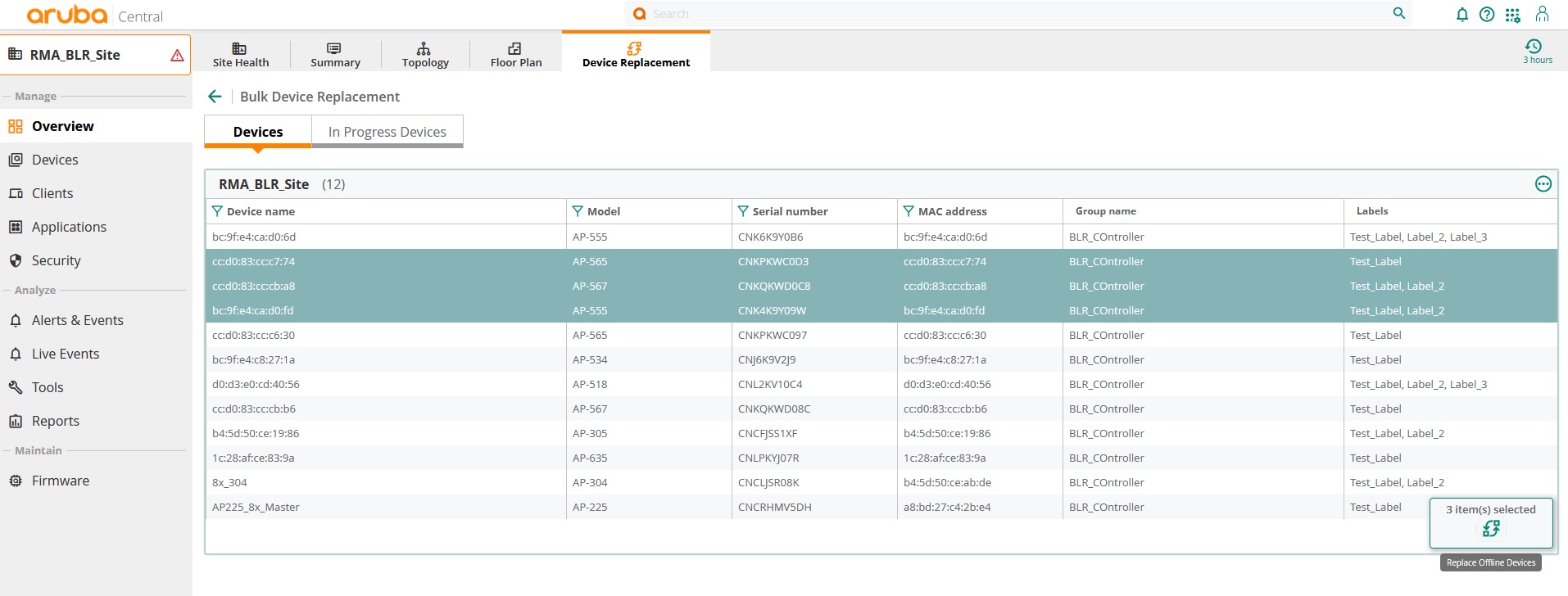

The following figure displays three offline APs that are selected for replacement in the Bulk Device Replacement page .
Figure 1 Bulk Device Replacement

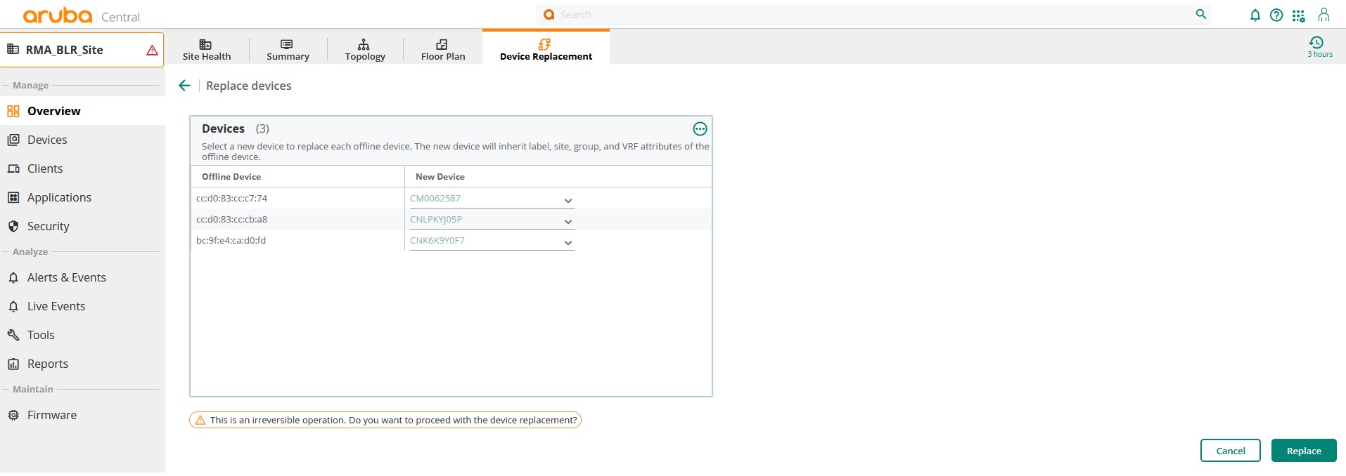

The following figure displays the Replace Devices page where serial number of the new APs are selected for replacement from the New Device drop-down list.
Figure 2 Replace Devices

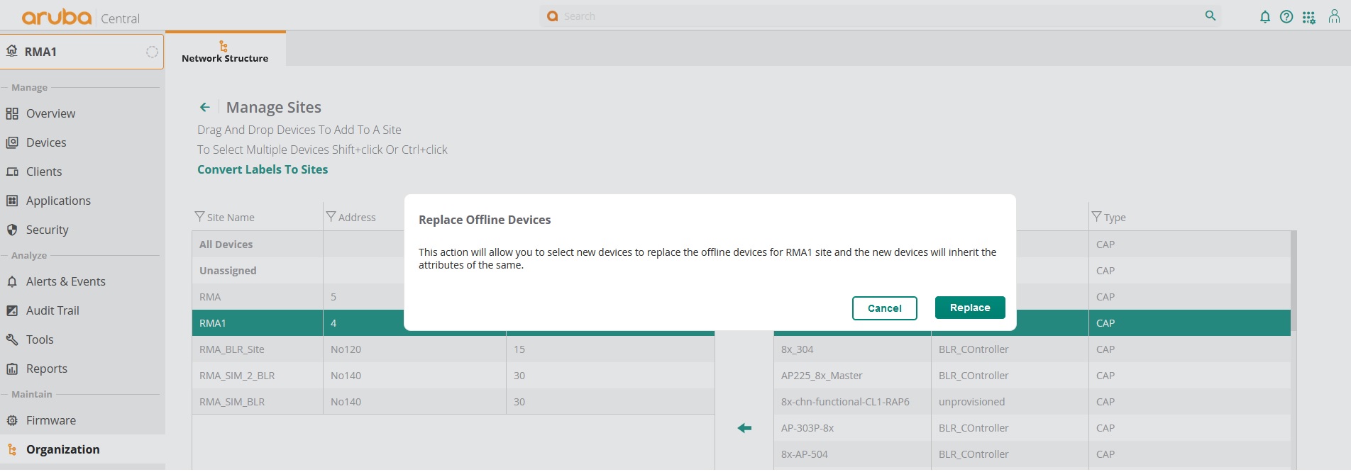

The following figure displays the Replace Offline Devices pop-up window under Manage Sites page.
Figure 3 Manage Sites
