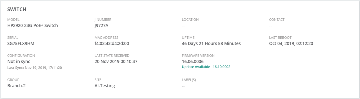

Switch
The Switch section displays the following details:
  • Model—Hardware model of the switch.
  • J-Number—Part number of the switch. This field is displayed only for standalone switches that are not part of switch stacks.
  • Location—Current location of the switch.
  • Contact—E-mail address of the contact person.
  • Conductor—Serial number of the conductor switch in a switch stack. This field is displayed only for switch stacks.
  • Serial—Serial number of the switch. This field is displayed only for standalone switches that are not part of switch stacks.
  • MAC Address—MAC address of the switch. This field is displayed only for standalone switches that are not part of switch stacks.
  • Uptime—Time duration for which the switches are operational.
  • Last Reboot—Timestamp of when the switch was last rebooted.
  • Configuration—Configuration status of the switch.
  • Last Sync:—Timestamp when the configuration was last synched between the peer switches in the stack.
  • Last Stats Received—Timestamp of when the last statistics were received.
  • Firmware Version—Firmware version of the switch. If an updated version is available, the version number is displayed and you can click the link to navigate to the firmware management page and upgrade the firmware.
  • Last Updated—Timestamp of when the switch firmware was last changed.
  • Firmware Status—Displays whether a new firmware version is available.
  • Group—Name of the group to which the switch belongs. Click the group name to view the dashboard context for the group.
  • Site—Name of the site to which the switch belongs. Click the site name to view the dashboard context for the site.
  • Label(s)—Name of the label to which the switch belongs.
Figure 1  Switch Overview

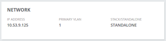

Network
The Network section displays the following details:
  • IP Address—IP address of the switch. For AOS-CX switches, a value is displayed only if the IP address is configured for the management interface of the switch. If IP address is obtained from the DHCP server, this field will appear blank for AOS-CX switches.
  • Default VLAN—Default VLAN ID of the switch.
  • Management VLAN—Management VLAN ID of the switch. This field is displayed only for AOS-Switches.
  • Stack/Standalone— Indicates whether the switch is part of a stack or if it is a standalone switch.
  • Stack Members—Total number of members in the stack. This field is displayed only for switch stacks.
  • Stack Topology—Topology of the stack.
  • Stack ID—Stack ID used to identify the stack. This field is displayed only for switch stacks.
Figure 2  Network Details

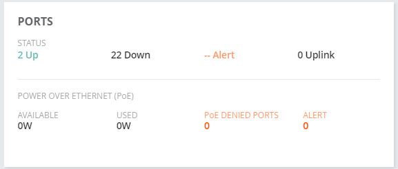

Ports
The Ports section displays the following details:
  • Status—Number of ports in Up and Down state, and number of alerts.
  • Power Over Ethernet (PoE)—Number of PoE ports enabled and disabled, and number of alerts.
Figure 3  Port Summary

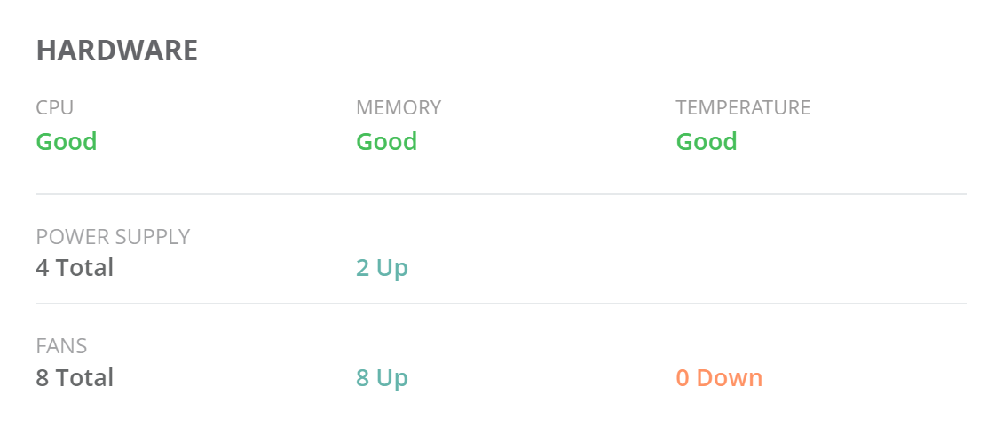

Hardware
The Hardware section displays the following details:
  • Power Supply—Total number of power supplies and number of power supplies in Up state.
  • Fans—Total number of fans and the number of fans in the Up and Down states.
  • CPU—CPU utilization status.
  • Memory—Memory utilization status.
  • Temperature—Temperature status. Hover your mouse over the status to view the temperature data.
Figure 4  Hardware Details

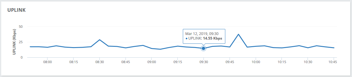

Uplink
The Uplink section displays the uplink rate (bps) trend chart for the duration specified in the time range filter. Hover the mouse over the trend chart to view the uplink rate at a particular time.
Figure 5  Uplink Trend Chart

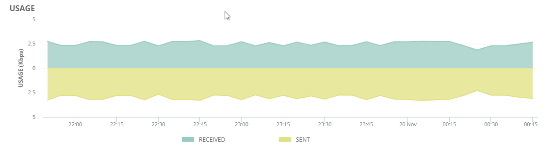

Usage
The Usage section displays the trend chart for client data traffic detected on the switch. Hover the mouse over the trend chart to view data transmitted and received at a particular time.
Figure 6  Usage Graph

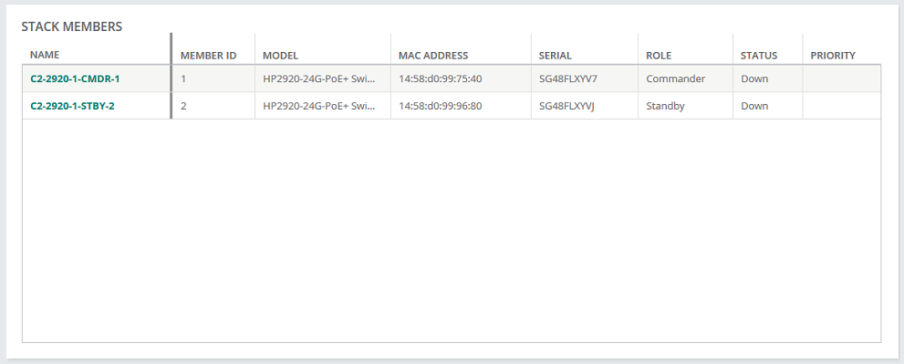

Stack Members
The Stack Members table displays the following details:
  • Name—Name of the switch stack member.
  • Member ID—Identification number of the member.
  • Model—The hardware model of the switch.
  • MAC Address— The MAC address of the stack member.
  • Serial— The serial number of the switch.
  • Role —The role of a stack member.
  • Status—The status of the switch stack member.
  • Priority—Priority of the member. This column is not displayed for AOS-CX switches.
Figure 7  Stack Members Table
