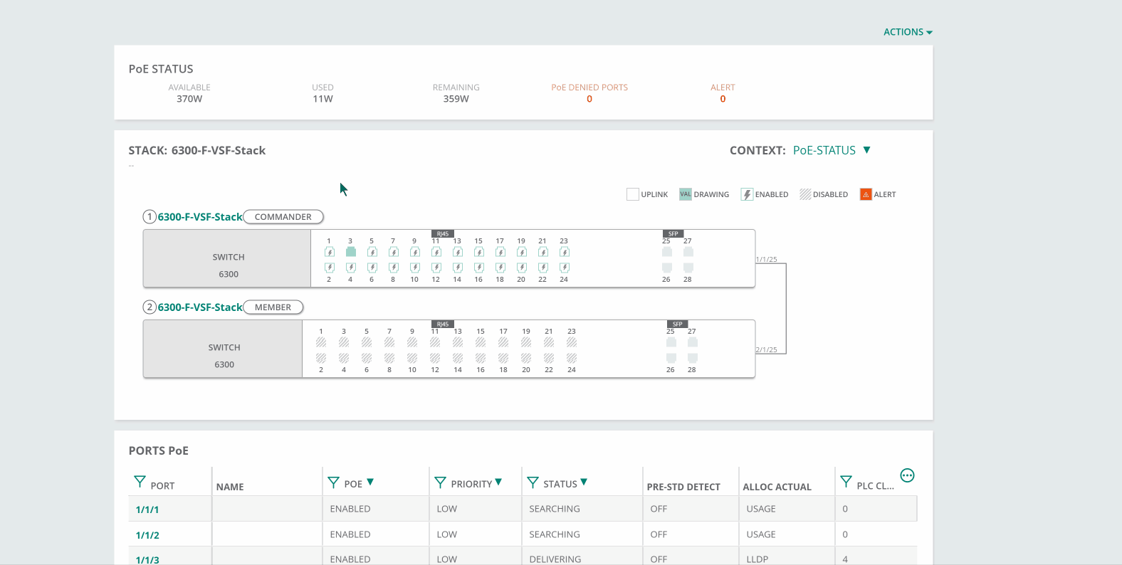

PoE Status
The PoE Status section displays the following details:
  • Available—Power available for consumption for the switch or stack.
  • Used—Power used by various devices.
  • Remaining—Power remaining to be utilized in the stack or device.
  • PoE Denied Ports—Number of ports for which power is denied.
  • Alerts—Number of alerts generated.

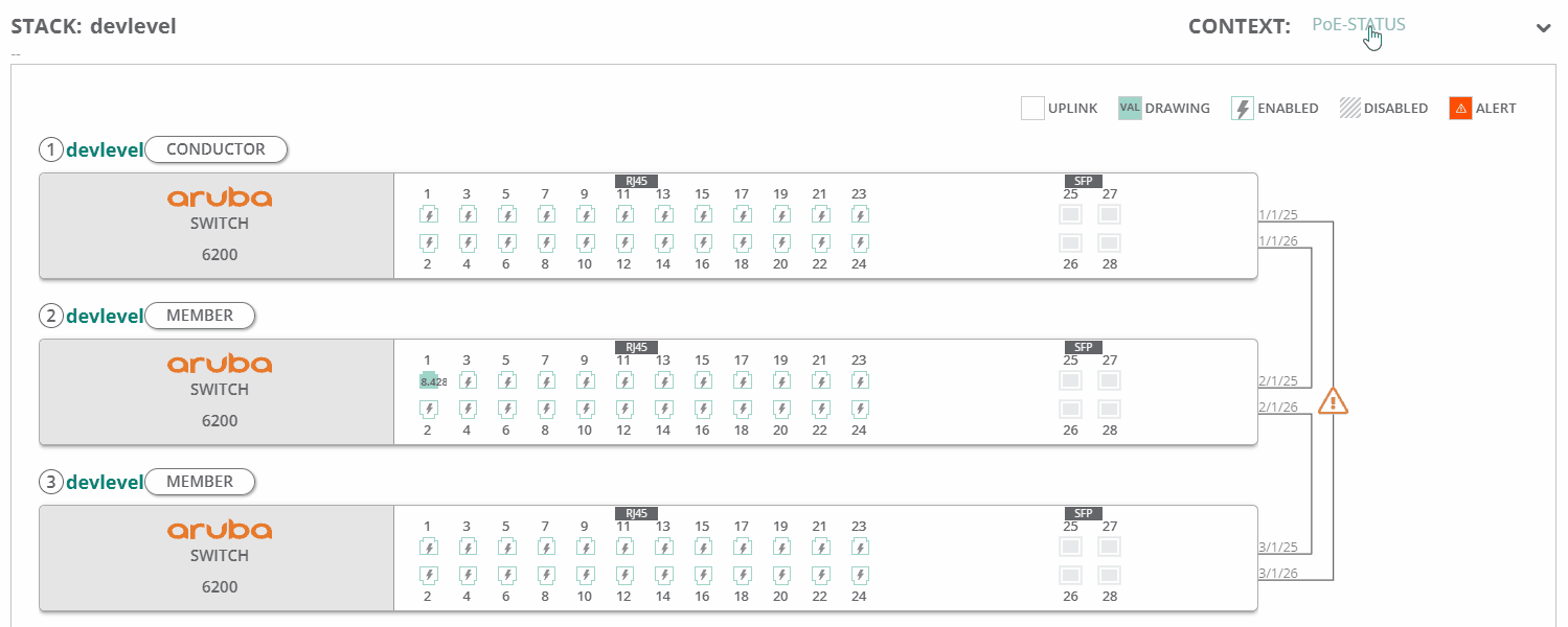

Faceplate
If the switch is a standalone switch, the faceplate of the switch is displayed. For a switch stack, faceplate of all the switches part of the stack is displayed. From the faceplate, click on the port to drill down and view port-level information. On the switch faceplate, hover over a PoE port to view the following details:
  • Port
  • Name
  • Type
  • Class
  • Priority
From the Context drop-down list, select the context:
  • POE-STATUS—Displays the sate of each port. The state can be: Uplink, Drawing, Enabled, Disabled, or Alert.
  • POE-CLASS—Power class of the PoE port. The class can be: Class0, Class1, Class2, Class3, Class4, or Disabled.
  • POE PRIORITY—PoE priority configured on the port. The priority can be: Critical, High, or Low.
The following animation shows how to set the context on the faceplate:
Ports PoE
The Ports PoE table displays the following details:
  • Port—Port number.
  • Name—Name of the port.
  • PoE—PoE state: Enabled or Disabled.
  • Priority—PoE priority: Critical, High, or Low.
  • Status—Current power status of the PoE port: Searching, Delivering, Disabled, or Fault.
  • Pre-STD Detect—Displays whether PoE for pre-802.3af-standard powered devices is enabled on the switch: On or Off.
  • Alloc Actual—Power actually being used on the port.
  • Alloc Configured—The maximum amount of power allocated for the port.
  • PLC Class—Power class of the PoE port.
  • PLC Type—Physical layer classification type.

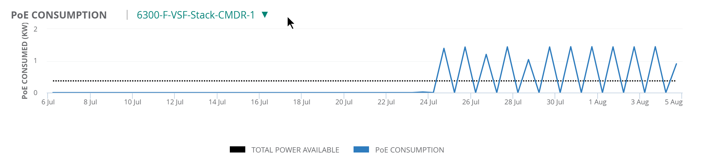

PoE Consumption
The PoE Consumption section displays a trend chart for the PoE power drawn from the Switch in watts. Hover your mouse over the trend chart to view the PoE power drawn at a particular time. For a stack, select the switch from the drop-down list to view the PoE consumption for the specific device.
The following animation shows how to view PoE consumption for a switch stack:
