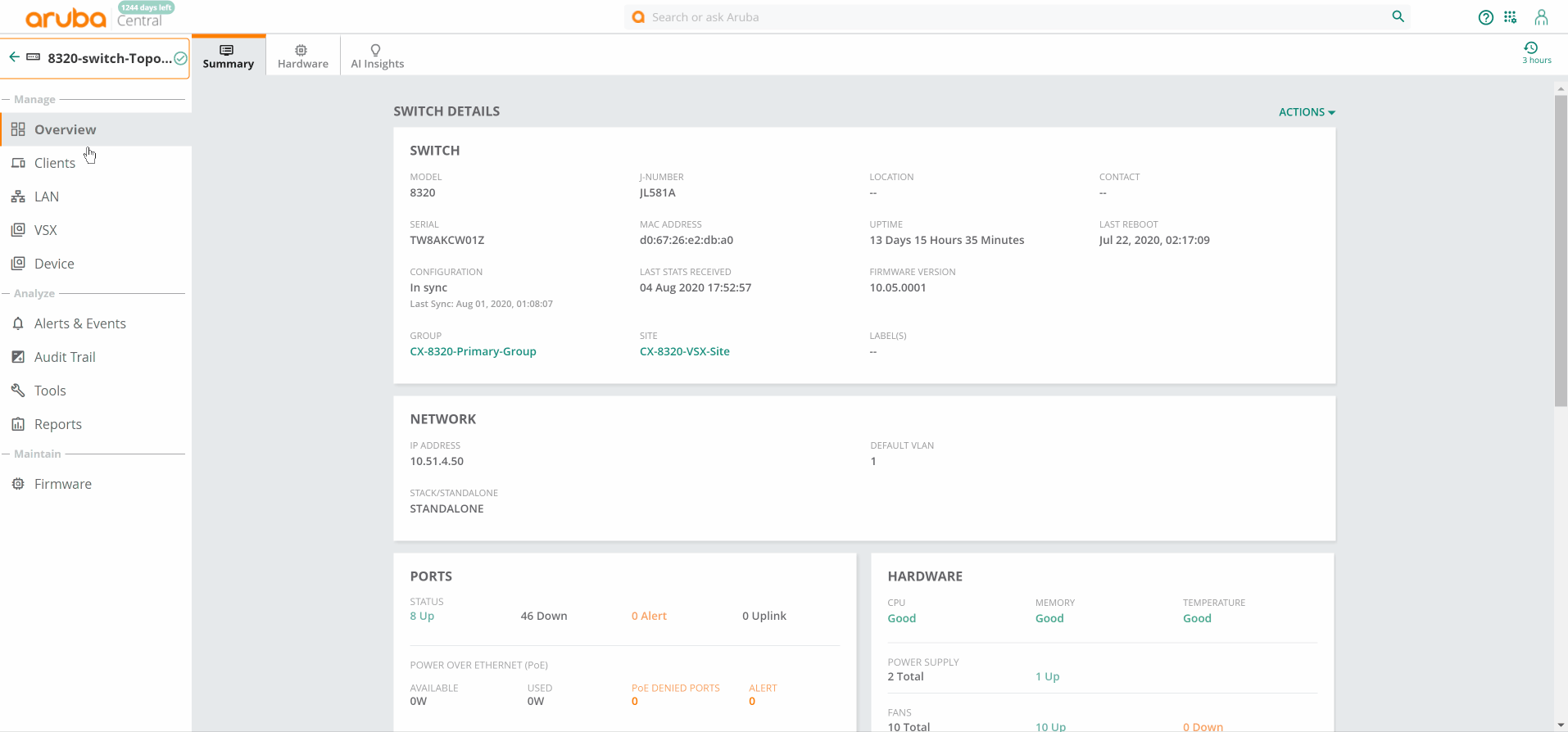

To navigate to the Ports tab in the Switch dashboard, complete the following steps:
  4. Under Manage, click LAN > Ports.
    The Ports tab is displayed.
