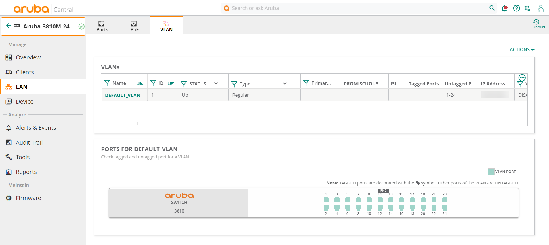

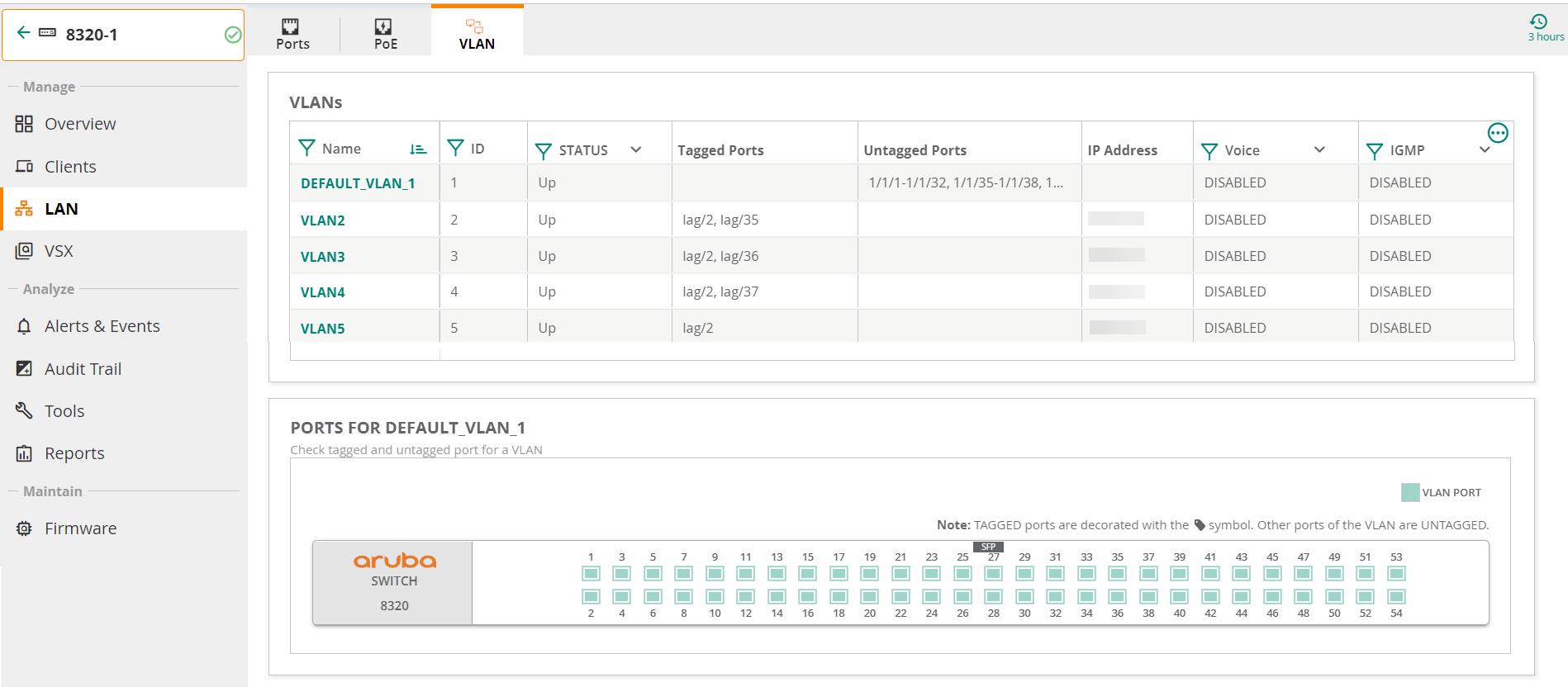

  • Jumbo—Displays whether the Jumbo packets are enabled or disabled for the VLAN.
Faceplate
From the VLANs table, select a VLAN to view the tagged and untagged ports, promiscuous port, ISL port, and the VLAN types in the faceplate.
Figure 1  VLANs tab details for AOS-Switch
Figure 2  VLANs tab details for AOS-CX switch
