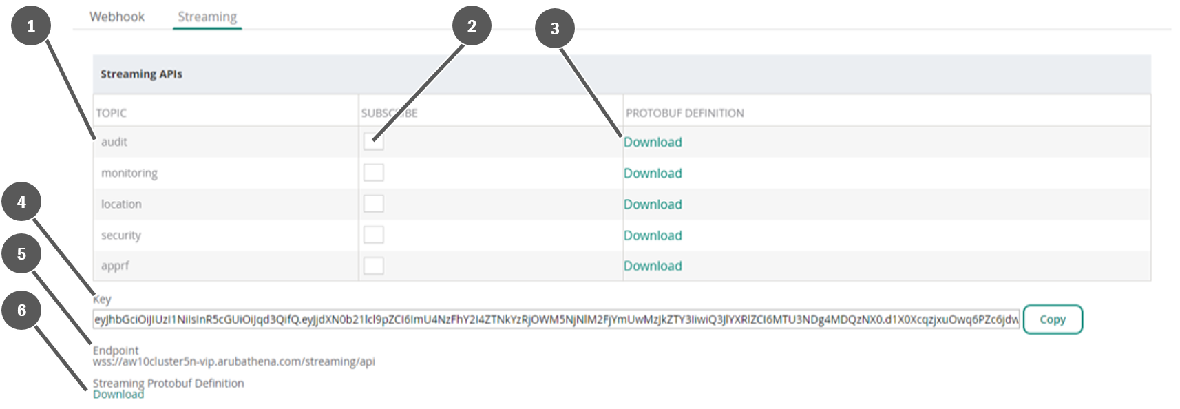

    The following is an illustration of the Streaming API page:
    Figure 1  View of the Streaming API Page
    The parameters in the page are described in the following table. Refer to the callout numbers.
    Table 1: Parameters of the Streaming API Page
    Callout
    APIDescription
    1
    Topic
    A list of available topics for streaming APIs. To receive streaming events from a topic, subscribe to the specific topic.
    2
    Subscribe
    Enables Aruba Central to stream events for a specific topic when this box is enabled.
    3
    Protobuf Definition
    Definition of the specific topic. All WebSocket response messages are encapsulated in a protocol buffer, the format of which you can download.
    4
    Key
    Access token for establishing a WebSocket connection.
    5
    Endpoint
    WebSocket endpoint address for the Aruba Central instance.
    6
    Streaming Protobuf Definition
    The protocol buffer in which all the incoming streaming messages are encapsulated. This protobuf is further used to identify the topic of the message received and decode the topic-specific protobuf message.
