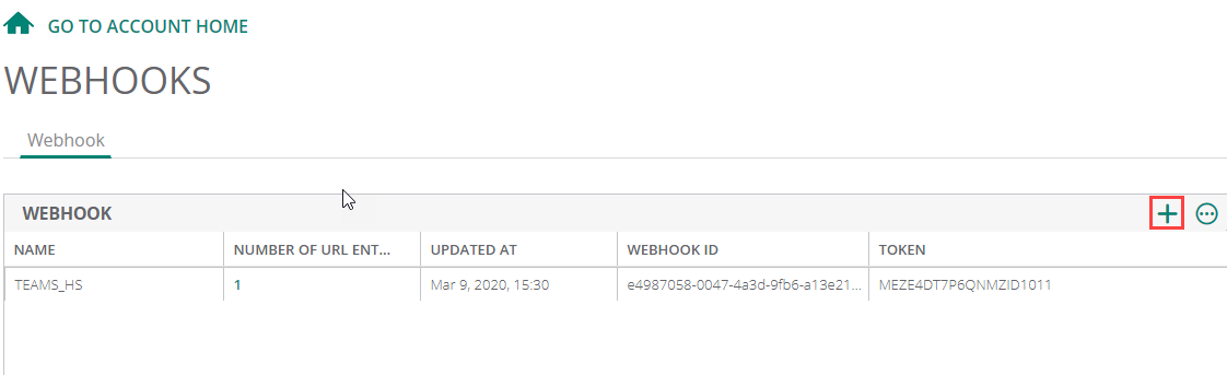

To access the Webhooks service from the UI:
  1. In the Account Home page, under Global Settings, click Webhooks.
    The Webhooks page is displayed.

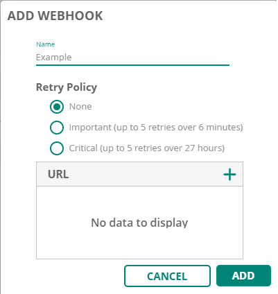

  2. In the Webhook tab, click + sign. The Add Webhook pop-up box opens.
    Figure 1  Webhooks Page
    Figure 2  Add Webhooks Page
  3. To create webhooks, enter the following details:
    1. Name—Enter a name for the Webhook
    2. Retry Policy— Select any one of the following options:
      • None—Select this to have no retry.
      • Important—Select this to have up to 5 retries over 6 minutes.
      • Critical—Select this to have up to 5 retries over 27 hours.
    3. URLs—Enter the URLUniform Resource Locator. URL is a global address used for locating web resources on the Internet.. Click + to enter another URL. You can add up to three URLs.
  4. Click Save. The Webhooks is created and listed in the Webhook table.
Viewing Webhooks
To view the Webhooks, complete the following steps:
The Webhook table displays the following information and also allows you to edit or delete Webhooks:
  2. The Webhooks page with Webhook table is displayed.
    The Webhook table allows you to edit or delete Webhooks and also displays the following information:
    • Name—Name of the Webhooks.
    • Number of URL Entries—Number of URLs in Webhooks. Click the number to view the list of URLs.
    • Updated At—Date and time at which Webhooks was updated.
    • Webhook ID—Webhooks ID.
    • Token—Webhooks token. Webhooks token enables header authentication and the third-party receiving service must validate the token to ensure authenticity.
    • Edit—Select the Webhook from the list and click the Edit icon to edit the Webhook. You can refresh the token and add URLs. Click Save to save the changes.
    • Delete—Select the Webhook from the list and click the Delete icon and click Yes to delete the Webhook.
    • Test Webhooks—Select the Webhook from the list and click the Test Webhooks icon to test the Webhook by posting sample webhook payload to the configured URL. The Test Webhooks table provides the URL and Status of the selected Webhook.

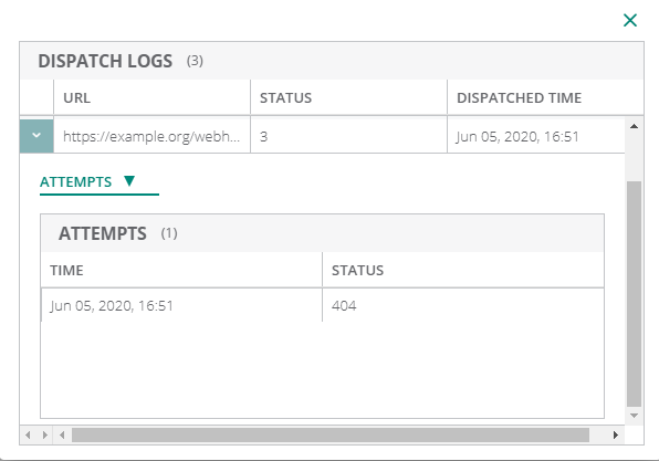

    • View Dispatch Logs—Select the Webhook from the list and click the View Dispatch Log icon to view the Dispatch Logs for the selected Webhook. The Dispatch Logs table provides the URL, Status, and Dispatched Time. Click the arrow against each row to view the Log Details and Attempts in the drop-down for the respective URL.
    Figure 3  Dispatch Logs Details Page
