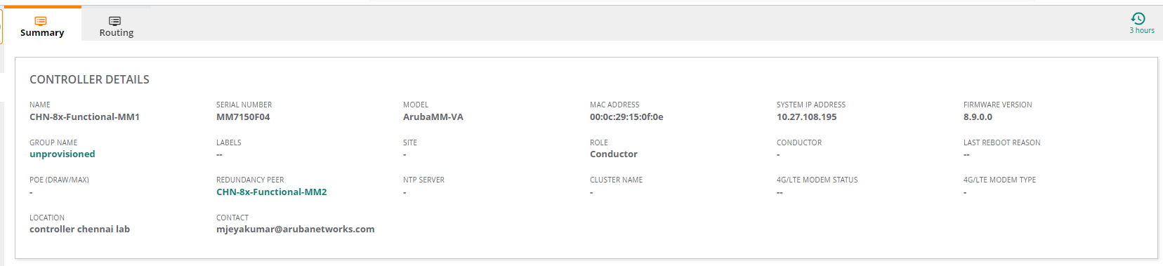

Device Info
The section displays the following details:
Figure 1 Device Info
- —The name of the controller.
—Serial number of the controller.
- —The hardware model of the controller.
- —The MACMedia Access Control. A MAC address is a unique identifier assigned to network interfaces for communications on a network. address of the controller.
- —The IP address of the controller.
- —The firmware version running on the controller. If a new version of the firmware is available, this information is also displayed. Clicking on the new firmware version redirects you to the Maintain > Firmware > controller page in the controller dashboard, where you can select the controller to upgrade it.
- —The name of the group, if the controller is configured as part of a group. Click the group name to go to the Overview > Summary page for that group.
- —The name of the label, if the controller is configured as part of a single or multiple labels.
- —The name of the site, if the controller is configured as part of a site. Hover over the i icon to display the complete address of the site. Click the site name to go to the Overview > Site Health page for that site.
- — The role of the controller; for example, conductor or local.
- — The name of the conductor controller.
- —The reason for the last reboot.
- —The amount of power that the devices connected to the controller consume and the maximum PoEPower over Ethernet. PoE is a technology for wired Ethernet LANs to carry electric power required for the device in the data cables. The IEEE 802.3af PoE standard provides up to 15.4 W of power on each port. power capacity. For example, if the value displayed is 6/120, the devices draw 6 watts and the maximum PoE power allocated is 120 watts.
- —Displays the redundant controller if it is configured.
- —The name of the NTPNetwork Time Protocol. NTP is a protocol for synchronizing the clocks of computers over a network. server configured and its synchronization status.
- —The name of the cluster controller.
- —Displays the modem connectivity status. The status shows only 'Connected' when the modem type is not internal.
- —Displays the LTELong Term Evolution. LTE is a 4G wireless communication standard that provides high-speed wireless communication for mobile phones and data terminals. See 4G. connection type.
Location—The currently configured physical location of the controller. Location details are displayed only for controllers running on firmware version ArubaOS 8.9.0.0 or later.
- Contact—The currently configured contact information of the controller. For example, E-mail ID or contact number. Contact details are displayed only for controllers running on firmware version ArubaOS 8.9.0.0 or later.

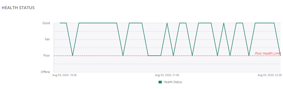

Health Status
The section displays the health of the controller in terms of CPUCentral Processing Unit. A CPU is an electronic circuitry in a computer for processing instructions., Memory and device connectivity to Aruba Central (on-premises).
The health status is plotted using health indicators such as Good, Fair, Poor and Offline. You can hover over the chart to see the health status for a particular time frame.
Figure 2 Health Status
