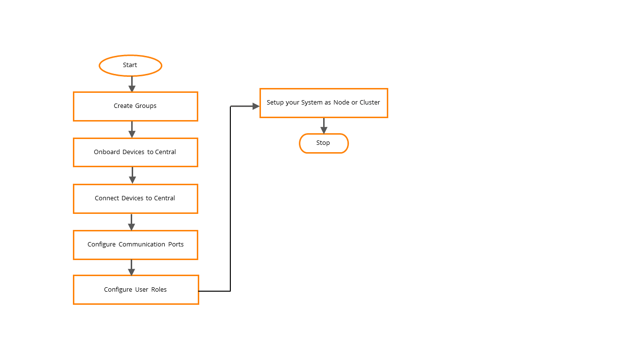

The following figure illustrates the workflow for getting started with Aruba Central (on-premises)
Figure 1  Aruba Central (on-premises) Getting Started Workflow
