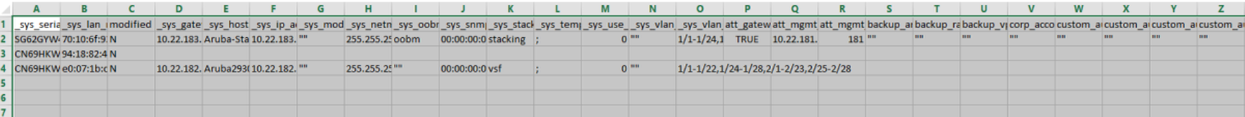

Downloading Sample Variables File
The sample variables file includes a set of sample variables that the users can customize. You can download the sample variables file in the JSONJavaScript Object Notation. JSON is an open-standard, language-independent, lightweight data-interchange format used to transmit data objects consisting of attribute–value pairs. JSON uses a "self-describing" text format that is easy for humans to read and write, and that can be used as a data format by any programming language. or CSVComma-Separated Values. A file format that stores tabular data in the plain text format separated by commas. format.
To download a sample variables file:
  1. In the Network Operations app, set the filter to one of the template group under Groups.
  3. Click the Config icon.
  4. Click Variables.
  5. Select one of the following formats to download the sample variables file:
    • JSON—shows the file in JSON format.
    • CSV—Shows the variables in different columns.
  6. Click Download Sample Variables File. The sample variables file is saved to your local directory.
Modifying a Variable File
The CSV file includes the following columns for which the variable definitions are mandatory:

Uploading Variable Files
To upload a variable file, complete the following steps:
  1. Ensure that the _sys_serial and _sys_lan_mac variables are defined with the serial number and MAC address of the devices, respectively.
  2. In the Network Operations app, set the filter to one of the template groups under Groups.
  3. Under Manage, click Devices > Switches.
  4. Click the Config icon.
  5. Click Variables.
  6. Click Upload Variables File and select the variable file to upload.
  7. Click Open. The contents of the variable file is displayed in the Variables table.
  8. To search for a variable, specify a search term and click Search icon.
  9. To download variable file with device-specific definitions, click the download icon in the Variables table
