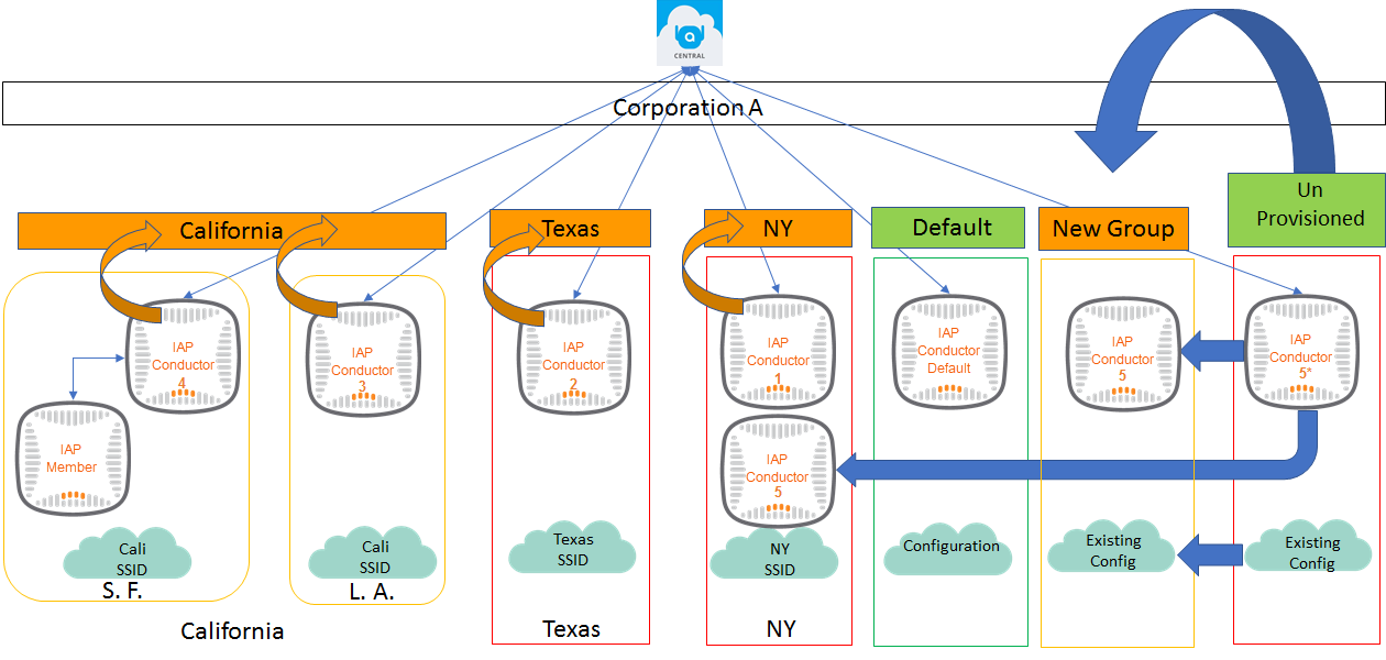

Ensure that the conductor AP and member APs are assigned to the same group. You must convert the member AP to a standalone AP in order to move the member AP to another group independently
In the following illustration, APs from three different geographical locations are grouped under California, Texas, and New York states. Each state has unique SSIDs and can support devices from multiple locations in a state. As shown in Figure 1, the California group has devices from different locations and has the same SSID, while devices in the other states/groups have different SSIDs.
When a device with the factory default configuration connects to Aruba Central (on-premises), it is automatically assigned to the default group. If the device has a custom configuration, it is marked as unprovisioned. If you want to preserve the custom configuration, create a new group for the device. If you want to overwrite the custom configuration, you can assign the device to an existing group.
Figure 1  AP provisioning
