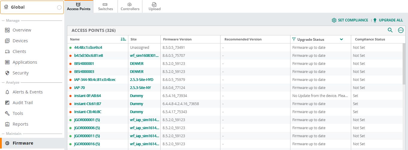

  2. Under Maintain, click Firmware. The Firmware dashboard displays the following information:
    The following image displays the Firmware dashboard at the global level:
