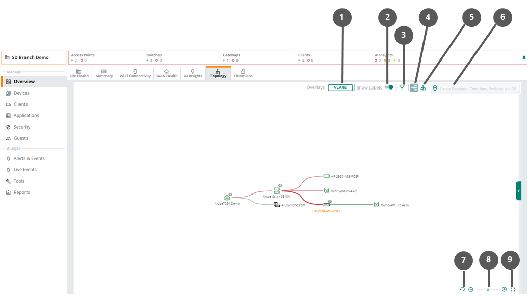

Features on Topology User Interface
The following figure shows the different features available on the Topology tab:
Figure 1   Features on Topology Tab
Table 1: Icon Details
Callout Number
Description
1
Click the icon to show or hide the VLANs pane.
2
Click the toggle switch to show or hide the device name.
3
Click the filter icon to filter the type of devices to be shown on the map. The following options are available:
  • Access Points—Allows you to show or hide the APs from the topology map.
  • Security Cloud—Allows you to show or hide the Zscaler and Palo Alto Prisma Access™ Cloud Service from the topology map.
  • Switch—Allows you to show or hide the switches from the topology map.
  • VPNC—Allows you to show or hide the VPNCs and the virtual gateways from the topology map.
  • Unmanaged—Allows you to show or hide the unmanaged devices from the topology map.
  • Show Devices Without Link—Allows you to show or hide the devices without link from the topology map.
4
Click the icon to view the topology map in a left to right orientation. The default orientation of the topology map is left to right orientation.
5
Click the icon to view the topology map in a top-down orientation.
6
The search bar allows you to locate a device in the topology map. The search bar field supports exact and partial text searches.
7
Click the icon to reset the topology map to the default view.
8
Click the , icons to change the zoom level of the topology map. Alternatively, you can drag the slider to set the zoom level of the topology map.
9
Click the icon to view the topology map in full-screen view. In the full-screen view, the device or link details feature is disabled in the topology map.
When the number of downstream devices connected to a device is less than or equal to 10, the devices are visible in the topology map. When the number of downstream devices connected to a device is more than 10, click the device icon to view the devices in the topology map. A bubble icon on the device represents the number of connected downstream devices.

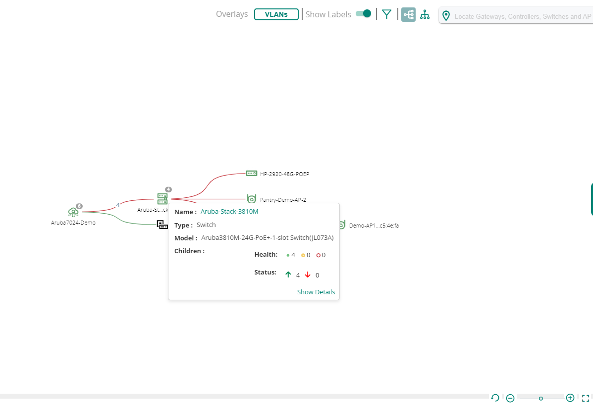

Device or Link Details
When you hover over a device or link, a pop-up displays the following details:
Figure 2  Device or Link Details
Table 3: Device or Link Details
Type
Description
Access Point
Displays the following details:
  • Name—Hostname of the access point.
  • Type—Type of the device.
  • Model—Hardware model of the access point.
  • Health Reason—The health status of the access point. This parameter is only available when the access point is offline.
  • Show Details—Click the link to view the Details pane.
Unmanaged
  • Name—Name of the unmanaged device.
  • IP Address—IP address of the unmanaged device.
NOTE: The value of the IP Address parameter is empty if LLDPLink Layer Discovery Protocol. LLDP is a vendor-neutral link layer protocol in the Internet Protocol suite used by network devices for advertising their identity, capabilities, and neighbors on an IEEE 802 local area network, which is principally a wired Ethernet. does not provide the neighbor information.
Switch
  • Name—Hostname of the switch.
  • Model—Hardware model of the switch.
  • Children—Number of devices connected to the switch categorized, based on the health and status of the devices. The Children field displays the following details:
    • Health—Count of devices connected to the switch based on the health of the device. For more information, see Icon Status.
    • Status—Count of devices connected to the switch based on the current status of the devices. The arrow in green indicates that the device is online. The arrow in red indicates that the device is offline.
  • VLANs—List of VLANs configured on the switch. This field is displayed only when the VLANs option is selected under Overlays. For more information, see VLAN Overlay Details.
Switch Stack
  • Name—Hostname of the switch stack.
  • Children—Number of devices connected to the switch categorized based on the health and status of the devices. The Children field displays the following details:
AOS-CX VSX Switch
  • Name—Name of the AOS-CX switch that is configured with VSX. The name is displayed in the VSX_<Device Name> format. For example, VSX_8320-switch-primary.
  • Model—Hardware model of the AOS-CX switch.
  • VSX Role—Role of the AOS-CX switch in the VSX configuration. Supported values are Primary and Secondary.
Edge
Displays the following information about the edge link:
  • <Interface of the device>—Interface number of the device.
  • <Name of the device>—Displays the name of the device.
  • Health Reason—Displays the health status of the down edge link. This parameter is only available when the edge link is down.
  • Alternative links—Number of the alternative links.
The edge in green color indicates that the edge is up. The edge in red color indicates that the edge is down.
Click the edge link to view the Details pane.
Unmanaged edge
Displays the following information about the link:
  • <Name of the connected device>—Name of the device connected with the edge link.
  • <Port Identifier>—Port number of the device.
The unmanaged edge in green color indicates that the unmanaged edge is up. The unmanaged edge in red color indicates that the unmanaged edge is down.
Click the unmanaged edge link to view the Details pane.
ISL edge in AOS-CX VSX toplogy map
  • ISL—Number of inter-switch link (ISL) present between the AOS-CX switches configured with VSX.
  • Other Links—Number of other links present between the AOS-CX switches configured with VSX.

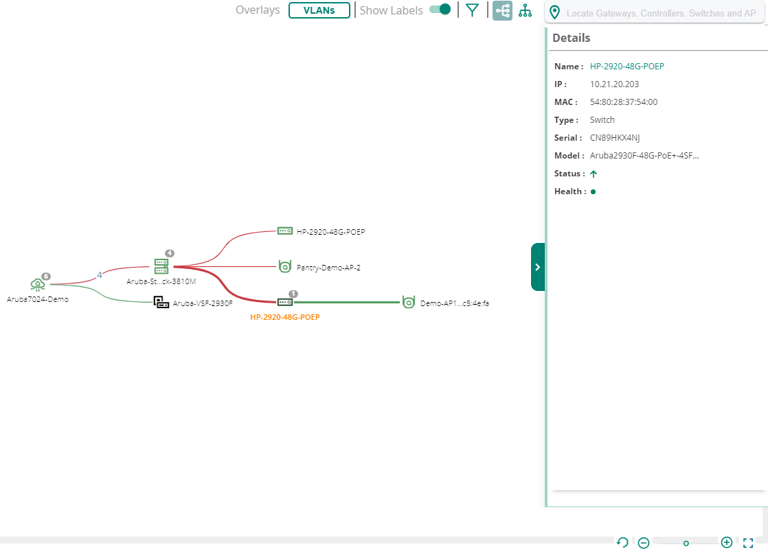

Details Pane
In the topology map, the Details pane provides a summary of the devices, uplinks, and tunnel details.
A green bullet icon indicates that the device health is good when the CPU usage is lower than or equal to 75% and the memory usage is lower than or equal to 75%. A yellow bullet icon indicates that the device health is fair when the CPU usage is greater than 75% and the memory usage is greater than 75%. A red bullet icon indicates that the device health is poor when the CPU usage is greater than 90% and the memory usage is greater than 90%. The arrow in green indicates that the device is online. The arrow in red indicates that the device is offline.
In the topology map, select a device and then click the Show Details link in the pop-up window to view the Details pane. To view the Details pane for a tunnel, uplink, or edge, click the link.
The Details task pane displays the following information:
Figure 3  Details Pane
Table 4: Contents of the Details Pane
Type
Description
Access Point
Unmanaged
  • Description—Description of the unmanaged device.
  • IP—IP address of the unmanaged device.
  • Capabilities—Displays the capabilities of the unmanaged device.
  • Supported—Lists the supported capabilities of the unmanaged device.
  • Enabled—Lists the enabled capabilities of the unmanaged device.
NOTE: The value of the parameters are empty if LLDP does not provide the neighbor information.
Switch
  • Name—Hostname of the switch. Click the switch name to view the Switch Details page.
  • IP—IP address of the switch.
  • MAC—MAC address of the switch.
  • Serial—Serial number of the switch.
  • Status—Operational status of the switch.
  • Health—Operational health of the switch.

Edge
  • Interface numbers—Interface numbers of the device.
  • Interface—Interface number of the individual device.
  • Serial—Serial number of the individual device.
  • Device Name—The name of the individual device.
  • Port Number—The port number of the individual device.
Unmanaged edge
Displays the following information about all the links:
  • Health Reason—Displays the health status of the edge link. This parameter is only available when the edge link is down.
  • Interface—Interface number of the device.
  • Serial—Serial number of the device.
  • Device Name—Name of the device.
  • Port Number—Port number of the device.
  • Interface—Interface number of the unmanaged device.
  • MAC—MAC address of the unmanaged device.
  • Device Name—Name of the unmanaged device.
  • Port Identifier—Displays the port ID, port name, or MAC address of the unmanaged device.
The topology map displays information about the VLANs configured on switches running AOS-Switch and AOS-CX software. To view the VLAN information:
  1. Select the VLANs option under Overlays. The VLANs pane is displayed and the network elements in the topology map, such as device icons and edge links, are grayed out.
    The VLANs pane displays the first 50 VLANs (unique VLAN ID and name pairs) in the ascending order of VLAN IDs. To search for other VLANs, click the search icon.
  2. Select a VLAN from the VLANs pane. You can also enter a VLAN name or ID in the search box.
  3. The topology map displays the following information:
    • The switches that have the selected VLANs configured are highlighted in a color depending on the status of the switch, green for online and red for offline.
    • The edge link connecting two switches is highlighted in blue, if the following conditions are met:
      • The VLAN IDs are present in both the switches and in the ports associated with the edge link between the switches.
      • The VLAN type (tagged or untagged) configured is the same in both the switches.
  4. Hover over the switch to view the list of all VLANs (comma separated) configured on the switch.
    The VLAN IDs are also listed as a range if consecutive VLAN IDs are configured. For example, 100-178, 190, 210.
  5. Hover over the edge link connecting the two switches. The pop-up displays the following information:
    • Host name of the switch
    • Serial number of the switch
    • VLAN ID
    • Type of VLAN: tagged, untagged, or missing
