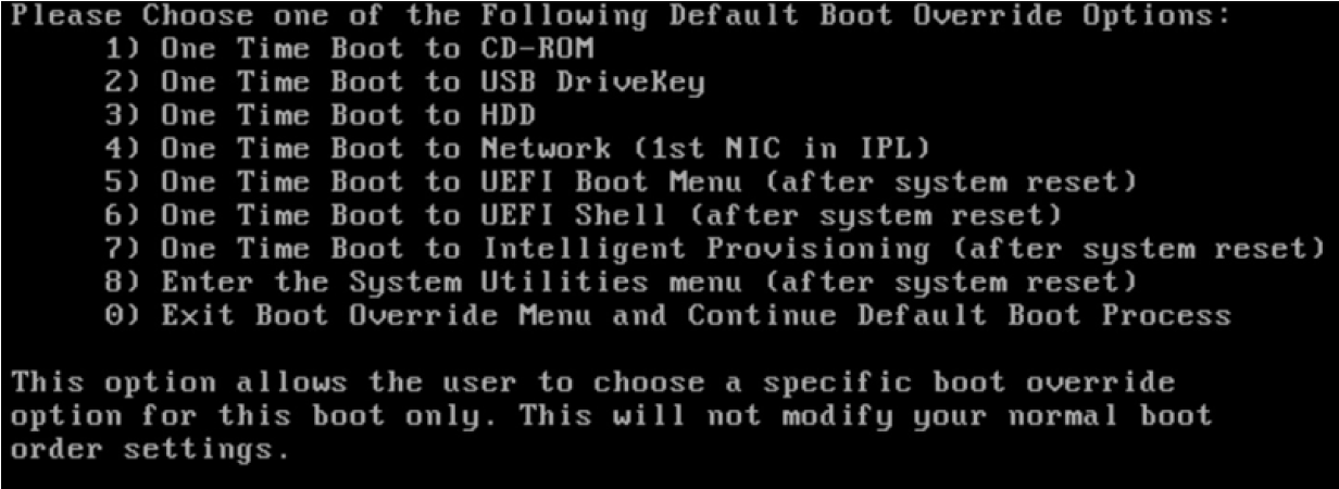

3. Press F11 to navigate to the boot options.
4. Select the Legacy Bios mode. The server will reboot again.
5. Press option 1 to boot from the CD-ROM.
6. The ENTER to Legacy BIOS One-Time Boot Menu or ESC to cancel. Enter (exit) |ESC (Cancel) message is prompted. Click OK.

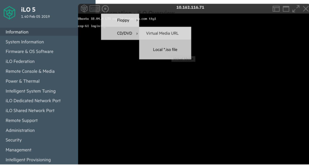

7. Connect to the Java Web Console or HTML console on the iLO.
8. Select the Disc icon > CD/DVD > Local *.iso file.
9. Browse and select the ISO file from the computer and the ISO file is mounted to the server.
10. Reboot using the iLO icon > Power > Reset. The server boots up with ISO image and installs the Aruba Central OS.

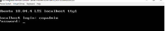

1. Login to HPE ProLiant server using the following default credentials:
Username: copadmin
Password: <chassis serial number of ProLiant server>
You can derive the serial number from the label of the Central appliance. For example, e.g. SGH****.

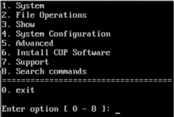

The Aruba Central CLI menu is displayed.
2. Enter 4 to select the System Configuration option and go to the next menu item.

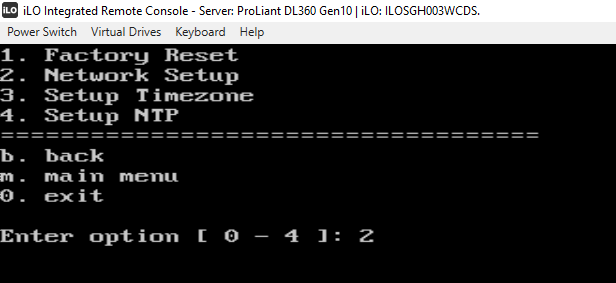

3. Enter 2 to select the Network Setup option and go to the next menu item.

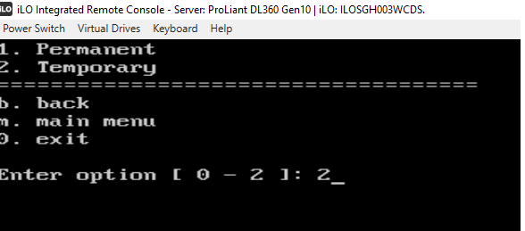

4. Enter 2 to select the Temporary Network Settings option and go to the next menu item.
5. When prompted, enter the following network settings to set up the temporary network:

1. In the Aruba Central CLI, enter 6 to select the Install COP Software option.
A list of available tarball file candidates is displayed.
2. Enter the number corresponding to the tarball file that is displayed in the list.
