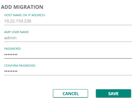

In the migration page, perform the following steps:
1. Enter the following details in the migration page:
—Enter the IP address of the AirWave Management Platform (AMP).
—Enter the user name for any administrative user.
—Enter the password associated with the administrative account.
—Re-enter the password.
2. Click to begin the migration process.
3. You can add multiple IP addresses to migrate from multiple AirWave servers to one Aruba Central (on-premises) server. In this case, each AMP will be migrated sequentially one after another.
Figure 1 Add Migration Using Host Name
Figure 2 Add Migration Using IP Address

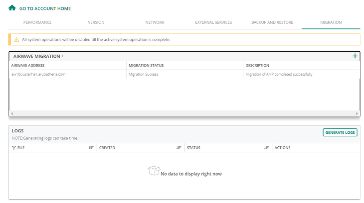

Validating the Migration Process
After you click on the migration window, the migration process starts. If multiple AMPs are added, each AMP will be migrated sequentially one after another.
Figure 3 Screen Capture of a successful Migration.
The default time out period for the backup process during the migration is . |
During the migration process, a fresh AMP back up is created in Airwave 8.x and transferred to the Aruba Central (on-premises). The scheduled nightly backup is not performed as a part of the migration process.

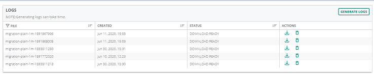

Logs
The table displays all the logs related to the migrations that are either complete or failed. Click to create the log files.
The log files that are generated contains the cumulative data of all the AMP migrations.
Figure 4 Log File
The table displays the following columns:
Name |
Description |
The name of the log file that is generated. |
The date and time when the log file is created. |
| Indicates the status of the logs that are generated. The status indicated is , , , or | |
Enables you to perform the following actions: Downloading the generated log files by clicking the download icon. The files are then saved to the local drive as a TAR file. Deleting the log file by clicking the delete icon. |
