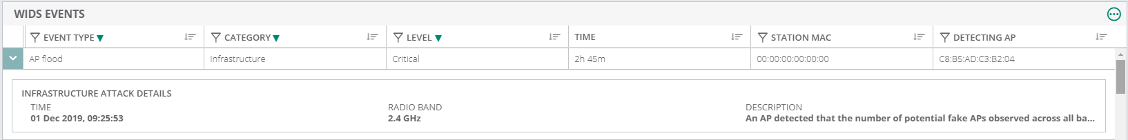

Intrusion Detection
The Manage >Security > Rapids > IDS page provides a summary of the total number of wireless attacks detected for a given duration.
The WIDS Events table displays the following information category:
Infrastructure attacks—Displays the number of infrastructure attacks detected in the network.
Client attacks—Displays the number of client attacks detected in the network.
Table 1: WIDS Events
Field
Description
Event Type
The type of the intrusion or attack detected. Click the drop-down arrow at the column heading to filter the event types based on your requirement.
Category
Category of the intrusion or attack, infrastructure or client attack. Click the drop-down arrow at the column heading to filter the category that you want to display.
Level
The level of the intrusion or attack detected. Click the drop-down arrow at the column heading to filter the attack level.
Time
Time of the intrusion or attack.
Station MAC
MAC address of the station under attack or BSSIDBasic Service Set Identifier. The BSSID identifies a particular BSS within an area. In infrastructure BSS networks, the BSSID is the MAC address of the AP. In independent BSS or ad hoc networks, the BSSID is generated randomly. of the AP under attack.
Detecting AP
The MAC address of the device that detected the intrusion or attack.
Radio Band
Radio bandBand refers to a specified range of frequencies of electromagnetic radiation. on which the intrusion was detected. There are two radio band signals available, 2.4 GHZ and 5 GHZ. Click the drop-down arrow at the column heading to filter the radio band where the intrusion was detected.
Description
Details of the attack or the intrusion.
Configuring IDS Parameters
The type and severity of Intrusion Detections raised by an AP is configurable and affects the data that is seen in the WIDS Events table. For more information on how to configure IDSIntrusion Detection System. IDS monitors a network or systems for malicious activity or policy violations and reports its findings to the management system deployed in the network. Parameters, see Aruba Central Help Center.

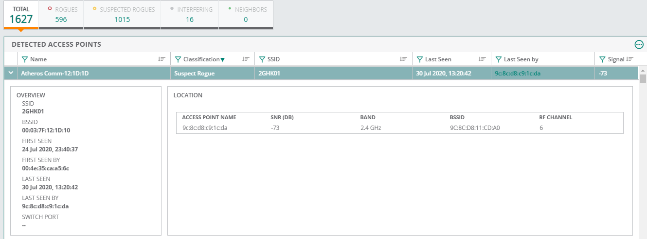

Rogue Detection and Classification
Aruba Central (on-premises) employs Rogue Access Point Intrusion Detection System as a security service for detecting and classifying rogues and intruders. Central discovers unauthorized devices in your WLANWireless Local Area Network. WLAN is a 802.11 standards-based LAN that the users access through a wireless connection. network using APs. It uses infrastructure APs routers and switches to locate, identify, and classify unknown APs. Security allows you to detect neighboring APs and classify them according to their threat level.
The access points in Aruba Central (on-premises) are classified as one of the following:
Table 2: Access Points Classification in Aruba Central (on-premises)
Classification
Description
Rogue AP
An unauthorized access point plugged into the wired side of the network.
Suspect Rogue AP
An unauthorized access point with a signal strength greater or equal to -75 that could have connected to the wired network.
Interfering AP
An access point seen in the RFRadio Frequency. RF refers to the electromagnetic wave frequencies within a range of 3 kHz to 300 GHz, including the frequencies used for communications or Radar signals. environment with a signal strength lesser than -75 but is not connected to the wired network. These access points may potentially cause RF interference, but cannot be considered as a direct security threat as these devices are not connected to the wired network. For example, an interfering AP can be an access point that belongs to a neighboring office’s WLAN but is not part of your WLAN network
Neighbors
A neighboring AP is when the BSSIDs are known. Once classified, a neighboring AP does not change its state.
The Manage >Security > Rapids > Rogues page displays the following information tabs:
Total—Shows the total number of rogues classified as Rogue , Suspected Rogue, or Interfering, that are detected in the network.
Rogues—Shows the total number of devices classified as rogue APs.
Suspected Rogues— Shows the total number of devices classified as suspected rogues APs.
Interfering—Shows the total number of devices classified as interfering APs.
Neighbors—Shows the total number of devices classified as neighbor APs.
Click the respective tabs to display specific rogue information pertaining to each classification. By default, the Total information tab is selected and the Detected Access Points table displays all the detected rogue APs.
Table 3: Rogues
Fields
Description
BSSID
The BSSIDs broadcast by the rogue device.
Name
Name of the rogue device detected in the network.
Classification
Classification of the rogue device (monitored device) as Suspect Rogue, or Interferer. Click the drop-down arrow at the column heading to filter the rogue classification that you want to display.
SSID
The SSIDService Set Identifier. SSID is a name given to a WLAN and is used by the client to access a WLAN network. broadcast by the rogue device.
Last Seen
The time relative to the current moment, for example, 6 minutes; an hour, at which the rogue device was last detected in the network.
Last Seen By
The AP name of the last device to report to have seen the monitored AP.
First Seen
The time relative to the current moment (for example, 6 minutes; an hour) at which the rogue device was detected in the network.
First Seen By
The AP name of the first AP to discover the monitored AP.
Signal
The signal strength of the AP that detected the rogue device.
Encryption
The type of encryption used by the device that detected the rogue; for example, WPAWi-Fi Protected Access. WPA is an interoperable wireless security specification subset of the IEEE 802.11 standard. This standard provides authentication capabilities and uses TKIP for data encryption., Open, WEPWired Equivalent Privacy. WEP is a security protocol that is specified in 802.11b and is designed to provide a WLAN with a level of security and privacy comparable to what is usually expected of a wired LAN. , Unknown. Generally, this field alone does not provide enough information to determine if a device is a rogue, but it is a useful attribute. If a rogue is not running any encryption method, you have a wider security hole than with an AP that is using encryption.
Containment Status
Details of the containment status. Click the drop-down arrow at the column heading to filter the status that you want to display.
MAC Vendor
The vendor name associated to the MAC OUIOrganizationally Unique Identifier. Synonymous with company ID or vendor ID, an OUI is a 24-bit, globally unique assigned number, referenced by various standards. The first half of a MAC address is OUI. of the rogue AP.
