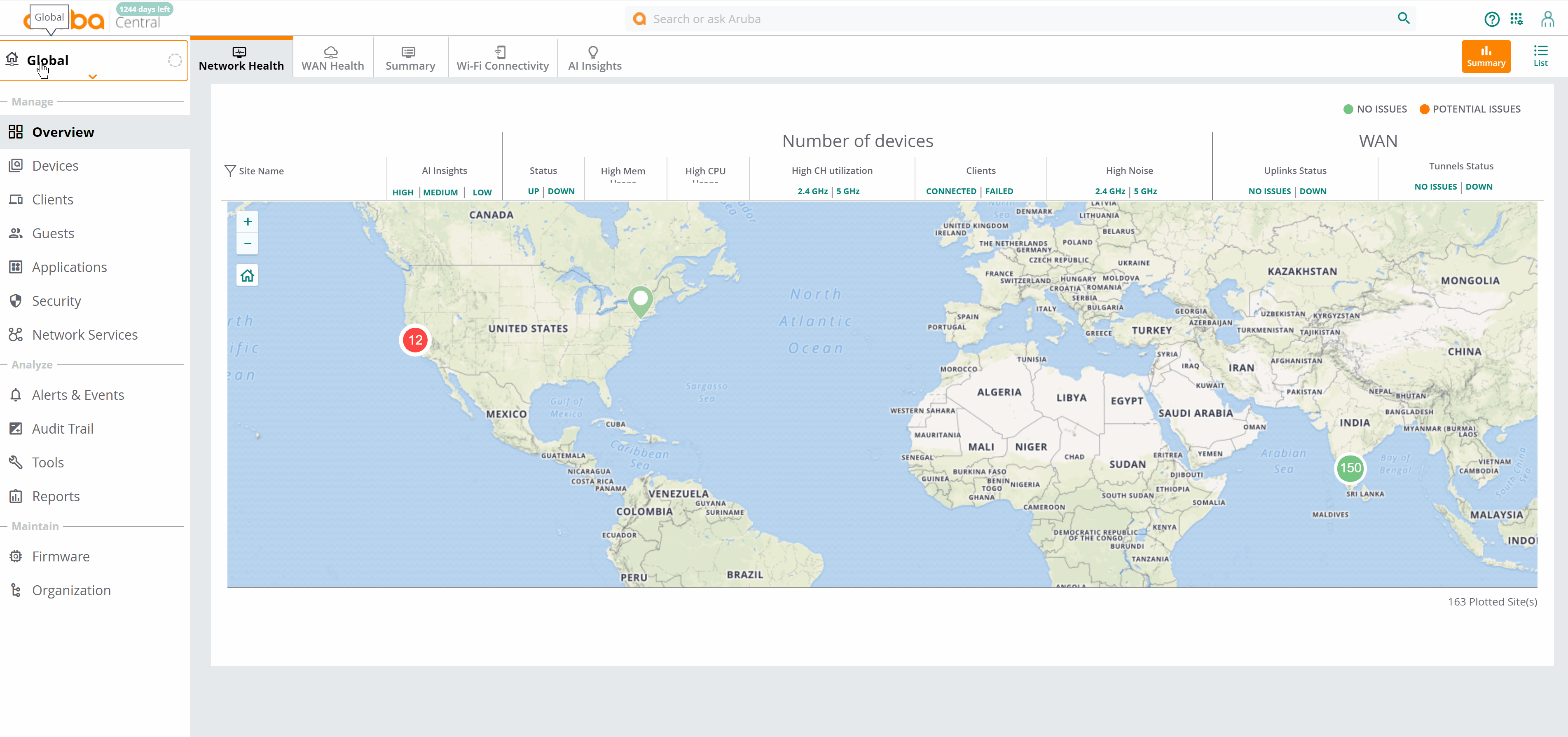

To delete an offline switch:
1. In the Network Operations app, set the filter to one of the options under Groups, Labels, or Sites. For all devices, set the filter to Global. Ensure that the filter selection contains at least one switch.
3. Click Offline to display a table with the list of offline switches.
4. In the Switches table, hover over the offline switch that you want to delete.
5. Click the delete icon.
To delete multiple offline switches, select the offline switches that you want to delete, and click the delete icon at the bottom of the page.
6. Click Yes in the Confirm Action dialog box.
The following animation shows you how to delete an offline switch:
