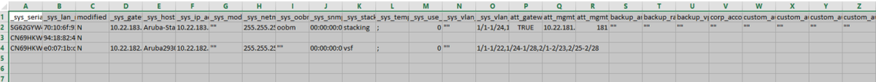

The CSV file includes the following columns for which the variable definitions are mandatory:
Predefined Variables for Aruba Switches
The system defined variables in the sample variables files are indicated with _sys prefix.

  1. Ensure that the _sys_serial and _sys_lan_mac variables are defined with the serial number and MAC address of the devices, respectively.
