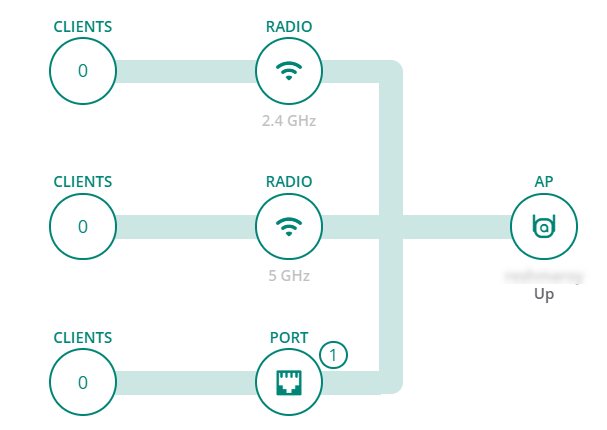

Data Path
The section displays the topology of the clients connected to each of the radios of the AP, which in turn is connected to switches or gateways through VLAN. When you hover over the upstream device in the data path topology, a pop-up displays the , , and details of the upstream devices.
PORT shows the number of ports available in the AP that also includes USBUniversal Serial Bus. USB is a connection standard that offers a common interface for communication between the external devices and a computer. USB is the most common port used in the client devices. ports. CLIENTS connected to the PORT in the data path shows the number of wired clients connected to the port.
Figure 1 Data Path

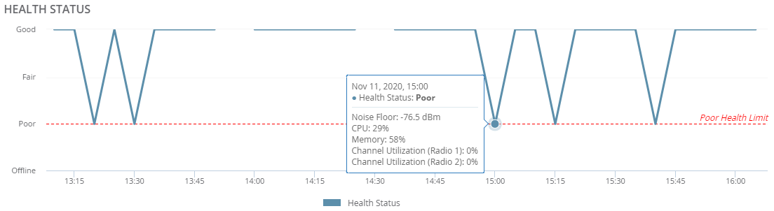

Health Status
The trend graph indicates the health status of the device in the network for the time selected in the time range filter. When you hover over the graph, you can view information such as date and time, , , , , , , and .
In the graph, the text indicates the poor health limit of the device in the network.
Figure 2 Health Status

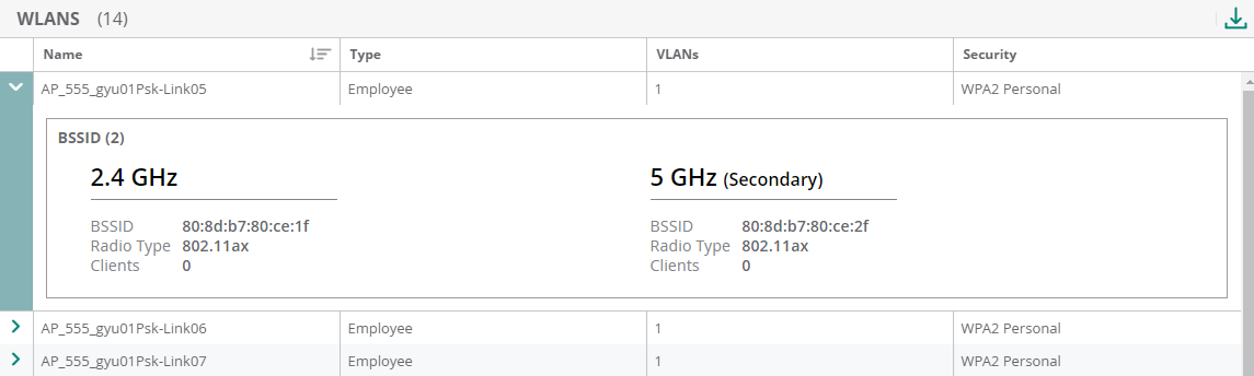

WLANS
The table provides a list of all the SSIDs configured for the AP.
Figure 3 WLANS
The table provides the following information:
- —Displays the name of the SSID.
In the table, the Type, VLANs, and Security values are empty.
Click
to expand an SSID in the table. When you expand an SSID in the table, you can view the following information for , , and radios:
- —Displays the MAC address of the radio.
- —Dispalys the type of radio.
- —Dispalys the number of connected clients.
Click
to download the file of the table.
- The tri-radio feature is available only for AP-555. In the table, the data is available only if the tri-radio mode is enabled. For more information, see About Tri-Radio Mode.
- In the file of the table, the columns are available only if the tri-radio mode is enabled.
