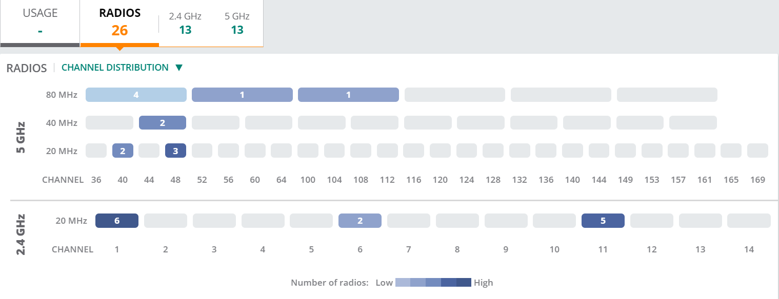

Channel Distribution
From the drop-down list, select Channel Distribution to display information on the frequency, at which each of the channels of the radio operate.
Figure 1  Channel Distribution

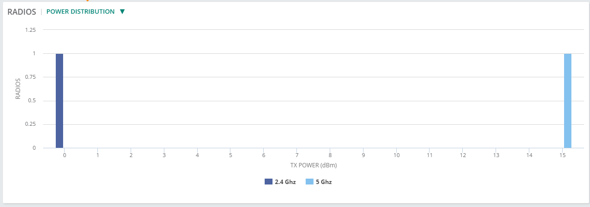

Power Distribution
From the drop-down list, select Power Distribution to display the power distributed across each of the radios.
Figure 2  Power Distribution

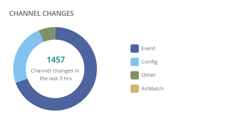

Channel Changes
The Channel Changes graph displays the number of channel changes that has occurred in the radios.
Figure 3  Channel Changes

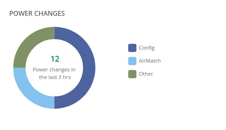

Power Changes
The Power Changes graph indicates the power change by each of the radios, from ARMAdaptive Radio Management. ARM dynamically monitors and adjusts the network to ensure that all users are allowed ready access. It enables full utilization of the available spectrum to support maximum number of users by intelligently choosing the best RF channel and transmit power for APs in their current RF environment. to AirMatch EIRPEffective Isotropic Radiated Power or Equivalent Isotropic Radiated Power. EIRP refers to the output power generated when a signal is concentrated into a smaller area by the Antenna..
Figure 4  Power Changes
