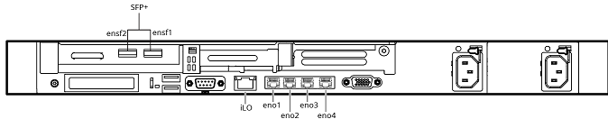

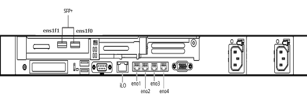

Connect the following cables to the correct ports based on the figure below:
- Connect an EthernetEthernet is a network protocol for data transmission over LAN. cable to the iLO port and to the switch which has DHCP IP.
- Connect another Ethernet cable to the eno1 port which is the Ethernet port.
- Connect a monitor to the VGA port on the server to see the iLO IP Address.
- Connect a key board to the server to setup the server.
Once the server is powered on and the cables connected to iLO and eno1, reboot the server using the power button or unplug and plug the power cable. The monitor displays the iLO IP address assigned by the DHCP server.

Following network interfaces are supported:
Select only one network interface to configure the server.

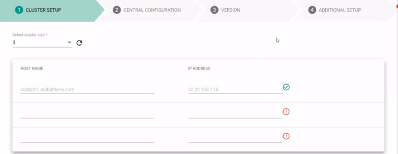

- In the tab of the Wizard, select the number of nodes (1, 3, 5 or 7) in the cluster from the drop-down list. Based on your selection, the number of Host Names and IP addresses fields are displayed.
Aruba Central automatically fills the conductor Host name and IP address.
- Enter the for each node. The IP address gets populated automatically when you enter the host name.
- Click .

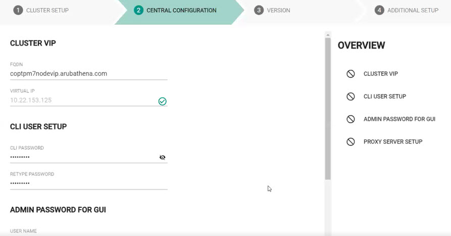

The tab is displayed.
- In the tab, enter the following network information for each node:
- FQDN of the node (for example, *company.com)
- Virtual IP address
- User name and password for the CLI administrator
- User name and password for the GUI administrator.
Add a network range for the pod and service network. This network range must be free of network devices or VPNVirtual Private Network. VPN enables secure access to a corporate network when located remotely. It enables a computer to send and receive data across shared or public networks as if it were directly connected to the private network, while benefiting from the functionality, security, and management policies of the private network. This is done by establishing a virtual point-to-point connection through the use of dedicated connections, encryption, or a combination of the two. settings.
- If you want to configure a proxy server, select the option, then enter the following information:
- Proxy server host name
- Proxy server port
- Proxy server user name and password
- Click .
