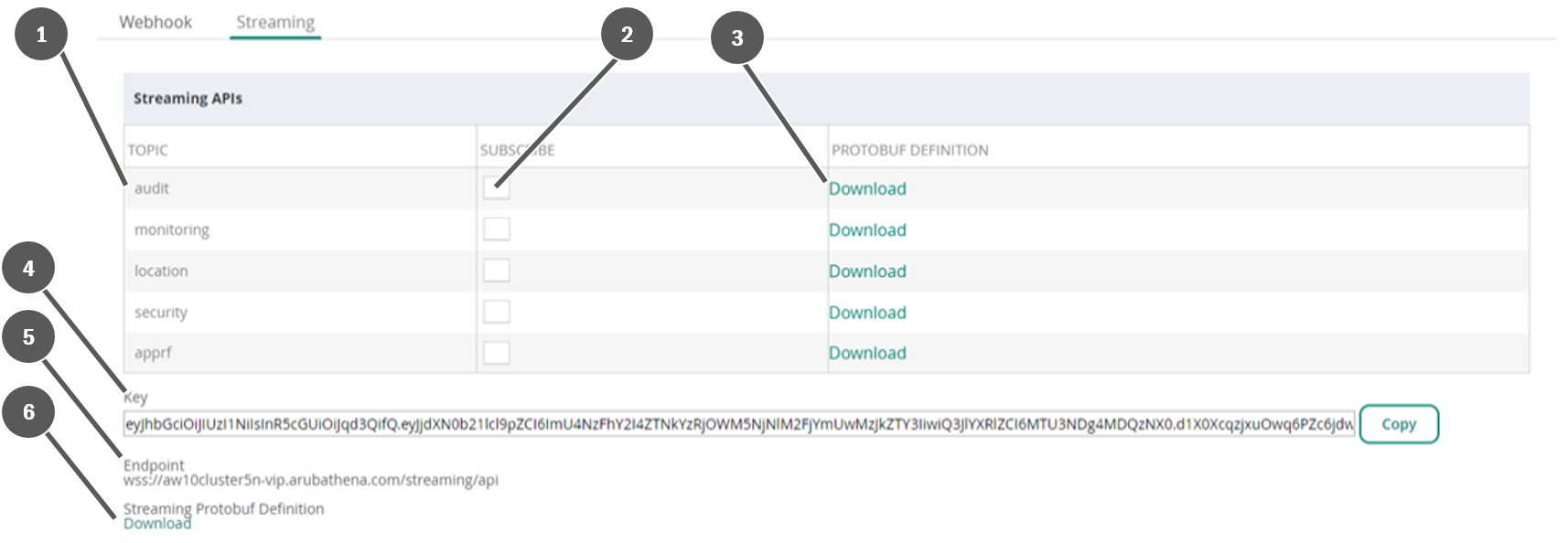

The following is an illustration of the Streaming API page:
Figure 1  View of the Streaming API Page
The parameters in the page are described in the following table. Refer to the callout numbers.
Table 1: Parameters of the Streaming API Page
Callout
API Description
1
Topic
A list of available topics for streaming APIs. To receive streaming events from a topic, subscribe to the specific topic.
2
Subscribe
Enables Aruba Central to stream events for a specific topic when this box is enabled.
3
Protobuf Definition
Definition of the specific topic. All WebSocket response messages are encapsulated in a protocol buffer, the format of which you can download.
4
Key
Access token for establishing a WebSocket connection.
5
Endpoint
WebSocket endpoint address for the Aruba Central instance.
6
Streaming Protobuf Definition
The protocol buffer in which all the incoming streaming messages are encapsulated. This protobuf is further used to identify the topic of the message received and decode the topic-specific protobuf message.

4. In the Streaming APIs tab, select the check box corresponding to the topic that you want to subscribe.
To unsubscribe a topic, clear the corresponding check box. The following topics are available for download:

4. In the Streaming APIs table, click the Download button corresponding to the protobuf definition for the topic to which you have subscribed.
