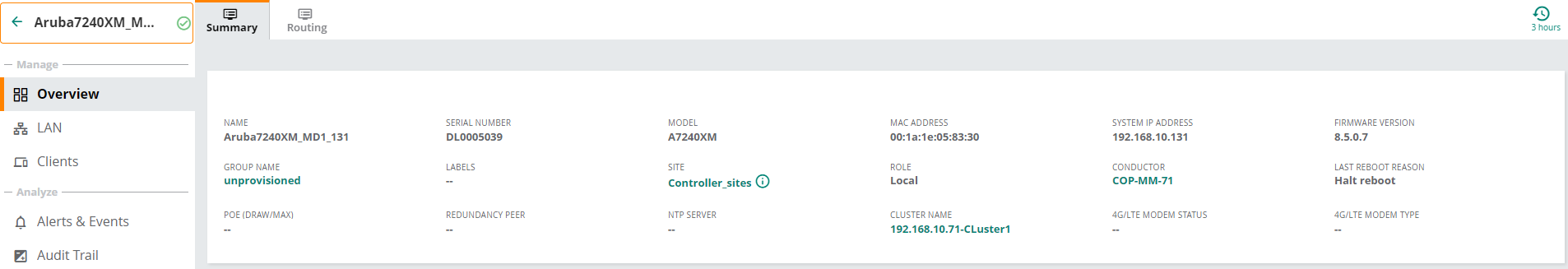

Device Info
The section displays the following details:
Figure 1 Device Info
- —The name of the controller.
- —The hardware model of the controller.
- —The MACMedia Access Control. A MAC address is a unique identifier assigned to network interfaces for communications on a network. address of the controller.
- —The IP address of the controller.
- —The firmware version running on the controller. If a new version of the firmware is available, this information is also displayed. Clicking on the new firmware version redirects you to the Maintain > Firmware > controller page in the controller dashboard, where you can select the controller to upgrade it.
- —The name of the group, if the controller is configured as part of a group. Click the group name to go to the Overview > Summary page for that group.
- —The name of the label, if the controller is configured as part of a single or multiple labels.
- —The name of the site, if the controller is configured as part of a site. Hover over the i icon to display the complete address of the site. Click the site name to go to the Overview > Site Health page for that site.
- — The role of the controller; for example, conductor or local.
- — The name of the conductor controller.
- —The reason for the last reboot.
- —The amount of power that the devices connected to the controller consume and the maximum PoEPower over Ethernet. PoE is a technology for wired Ethernet LANs to carry electric power required for the device in the data cables. The IEEE 802.3af PoE standard provides up to 15.4 W of power on each port. power capacity. For example, if the value displayed is 6/120, the devices draw 6 watts and the maximum PoE power allocated is 120 watts.
- —Displays the redundant controller if it is configured.
- —The name of the NTPNetwork Time Protocol. NTP is a protocol for synchronizing the clocks of computers over a network. server configured and its synchronization status.
- —The name of the cluster controller.
- —Displays the modem connectivity status. The status shows only 'Connected' when the modem type is not internal.
- —Displays the LTELong Term Evolution. LTE is a 4G wireless communication standard that provides high-speed wireless communication for mobile phones and data terminals. See 4G. connection type.
- —The status of the configuration sync. Hover over the i icon to display the last successful configuration sync time.

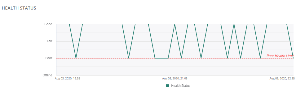

Health Status
The section displays the health of the controller in terms of CPUCentral Processing Unit. A CPU is an electronic circuitry in a computer for processing instructions., Memory and device connectivity to Aruba Central (on-premises).
The health status is plotted using health indicators such as Good, Fair, Poor and Offline. You can hover over the chart to see the health status for a particular time frame.
Figure 2 Health Status
