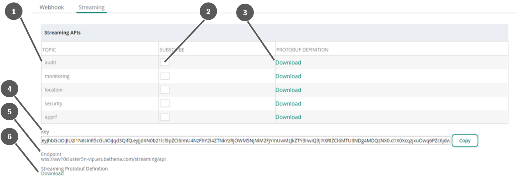

The following is an illustration of the page:
Figure 1 View of the Streaming API Page
The parameters in the page are described in the following table. Refer to the callout numbers.
Table 1: Parameters of the Streaming API Page
Callout
API Description 1
A list of available topics for streaming APIs. To receive streaming events from a topic, subscribe to the specific topic.
2
Enables Aruba Central to stream events for a specific topic when this box is enabled.
3
Definition of the specific topic. All WebSocket response messages are encapsulated in a protocol buffer, the format of which you can download.
4
Access token for establishing a WebSocket connection.
5
WebSocket endpoint address for the Aruba Central instance.
6
The protocol buffer in which all the incoming streaming messages are encapsulated. This protobuf is further used to identify the topic of the message received and decode the topic-specific protobuf message.
