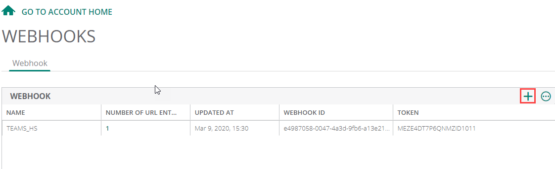

  1. In the Account Home page, under Global Settings, click Webhooks.
    The Webhooks page is displayed.
  2. In the Webhook tab, click + sign. The Add Webhook pop-up box opens.
    Figure 1  Webhooks Page
    Figure 2  Add Webhooks Page

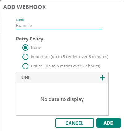

  3. To create webhooks, enter the following details:
    1. Name—Enter a name for the Webhook
    2. Retry Policy— Select any one of the following options:
      • None—Select this to have no retry.
      • Important—Select this to have up to 5 retries over 6 minutes.
      • Critical—Select this to have up to 5 retries over 27 hours.
    3. URLs—Enter the URLUniform Resource Locator. URL is a global address used for locating web resources on the Internet.. Click + to enter another URL. You can add up to three URLs.
  4. Click Save. The Webhooks is created and listed in the Webhook table.
  2. The Webhooks page with Webhook table is displayed.

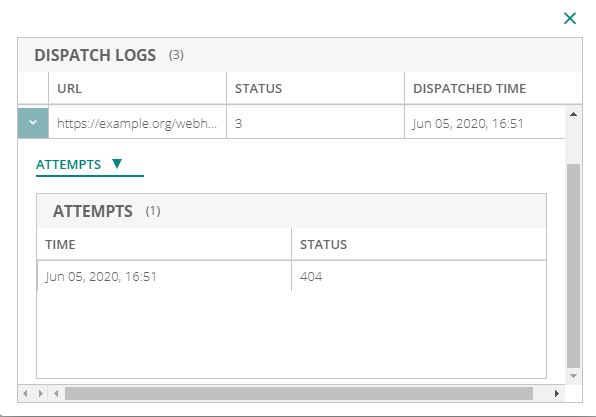

    • View Dispatch Logs—Select the Webhook from the list and click the View Dispatch Log icon to view the Dispatch Logs for the selected Webhook. The Dispatch Logs table provides the URL, Status, and Dispatched Time. Click the arrow against each row to view the Log Details and Attempts in the drop-down for the respective URL.
    Figure 3  Dispatch Logs Details Page
