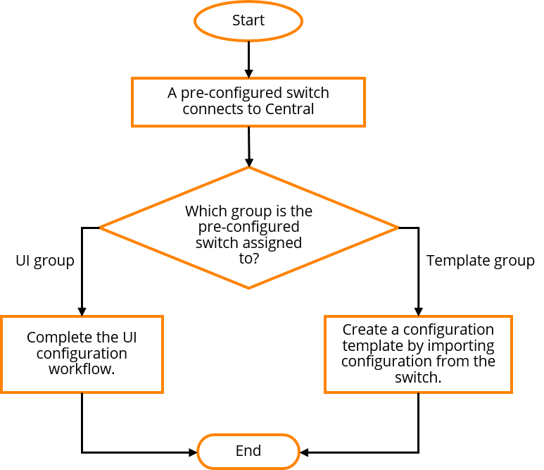

The following figure illustrates provisioning procedure for a pre-configured switch.
Figure 1  Provisioning Workflow for Pre-Configured Switches

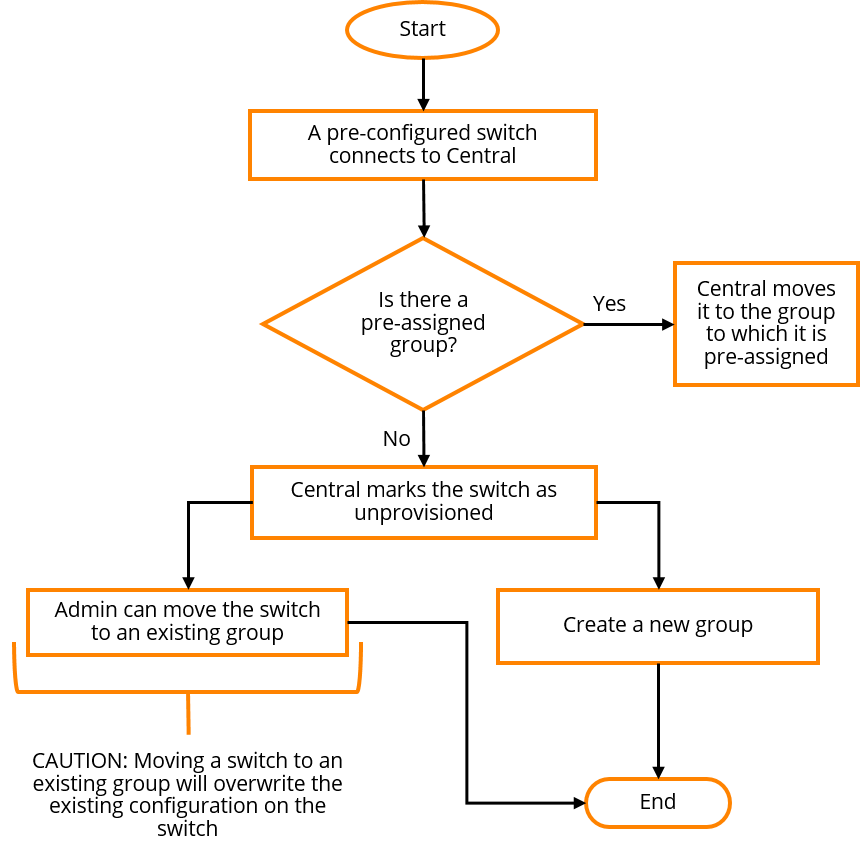

Step 4: Provision the AOS-Switch to a Group
When the switch connects to Aruba Central, Aruba Central automatically assigns it to the pre-assigned group. The following figure illustrates the provisioning steps for each group type.
Figure 2  Switch Provisioning Steps Per Group Type
If the switch is assigned to a new UI group, you can modify the configuration of switches in a group using the UI menu options under the Network Operations app > Manage > Device(s) > Switches. For more information, see Configuring AOS-Switches in UI Groups.
If you have assigned the switch to a template group, you can import the existing configuration to a new configuration template and apply this template to other devices in the group. To create a configuration template using the existing configuration on the switch:
If the switch has a valid subscription assigned, Aruba Central marks the switch as unprovisioned. To preserve the switch configuration, move it to a new group.
