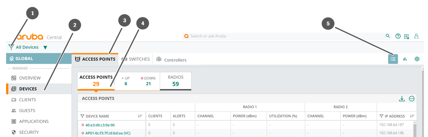

The following image displays the navigational elements of the app.
Figure 1 Navigation Elements of the Network Operations App
Callout Number |
Description |
1 |
Filter to select an option under , , . For all devices, select . A corresponding dashboard is displayed. |
2 |
Item under the left navigation contextual menu. The menu is dependent on the filter selection. |
3 |
First-level tab on the dashboard. |
4 |
Second-level tab on the dashboard. |
5 |
Dashboard content for the selected view and filter. For example, the current dashboard in the image displays the tab under > in the view for the filter. |
6 |
Time range filter. This is displayed for selected dashboards only. |
7 |
view to display tabular data for the selected filter. This is displayed for selected dashboards only. |
8 |
view to display charts for the selected filter. This is displayed for selected dashboards only. |
9 |
view to enable configuration options for the selected filter. This is displayed for selected dashboards only. |

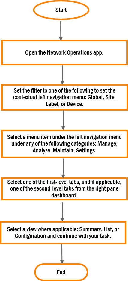

Workflow to Configure, Monitor, or Troubleshoot in the Network Operations App
The following image displays a flowchart to help you navigate the app to complete any task.
Figure 2 Navigation Workflow for Network Operations App
