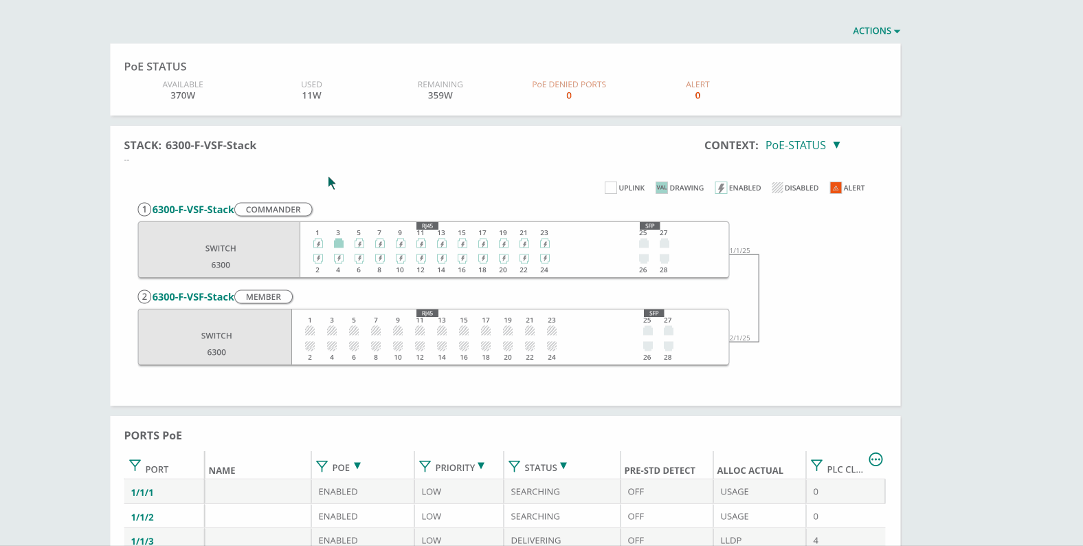

PoE Status
The PoE Status section displays the following details:
Available—Power available for consumption for the switch or stack.
Used—Power used by various devices.
Remaining—Power remaining to be utilized in the stack or device.
PoE Denied Ports—Number of ports for which power is denied.
Alerts—Number of alerts generated.

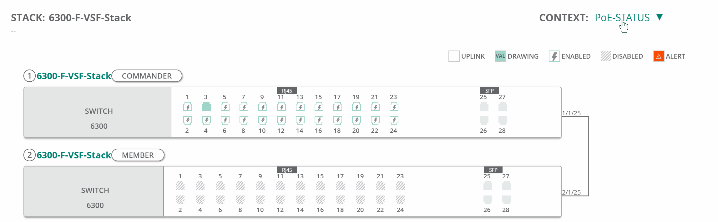

Faceplate
If the switch is a standalone switch, the faceplate of the switch is displayed. For a switch stack, faceplate of all the switches part of the stack is displayed. From the faceplate, click on the port to drill down and view port-level information. On the switch faceplate, hover over a PoE port to view the following details:
Port
Name
Type
Class
Priority
From the Context drop-down list, select the context:
POE-STATUS—Displays the sate of each port. The state can be: Uplink, Drawing, Enabled, Disabled, or Alert.
POE-CLASS—Power class of the PoE port. The class can be: Class0, Class1, Class2, Class3, Class4, or Disabled.
POE PRIORITY—PoE priority configured on the port. The priority can be: Critical, High, or Low.
The following animation shows how to set the context on the faceplate:
Ports PoE
The Ports PoE table displays the following details:
Port—Port number.
Name—Name of the port.
PoE—PoE state: Enabled or Disabled.
Priority—PoE priority: Critical, High, or Low.
Status—Current power status of the PoE port: Searching, Delivering, Disabled, or Fault.
Pre-STD Detect—Displays whether PoE for pre-802.3af-standard powered devices is enabled on the switch: On or Off.
Alloc Actual—Power actually being used on the port.
Alloc Configured—The maximum amount of power allocated for the port.
PLC Class—Power class of the PoE port.
PLC Type—Physical layer classification type.
