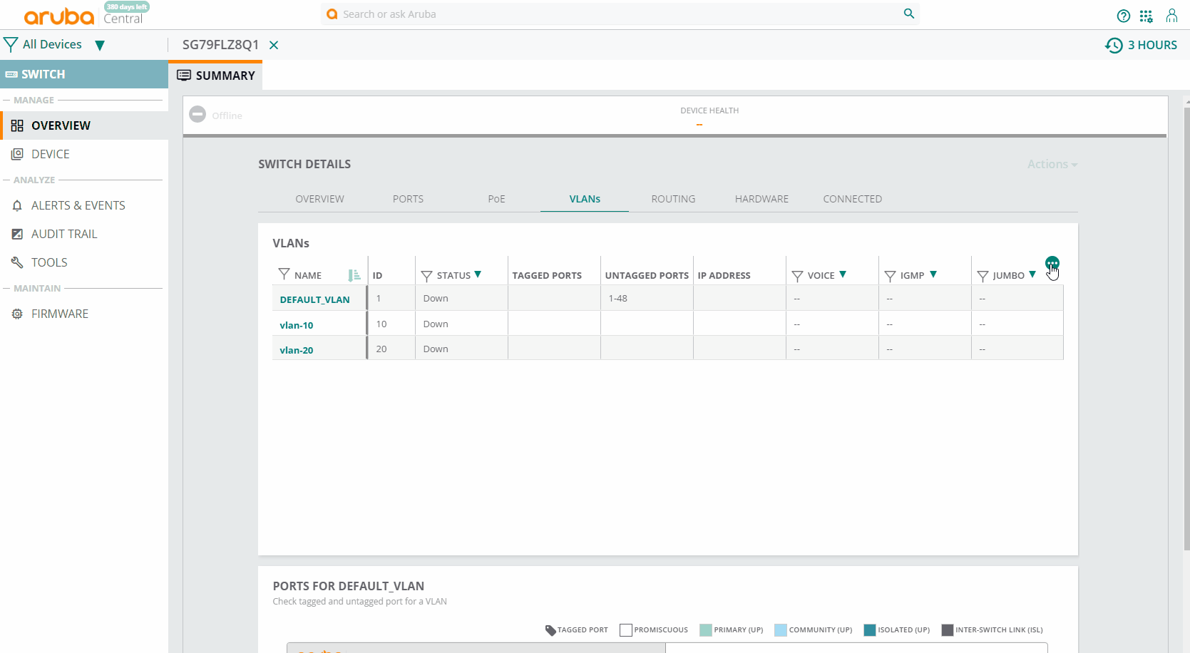

Figure 1  VLANs tab details for Aruba Switch

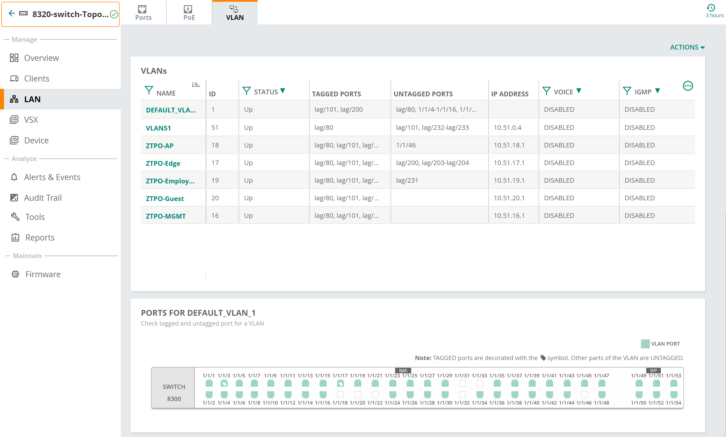

Figure 2  VLANs tab details for Aruba CX switch
The following is an illustration of the VLANs tab:
